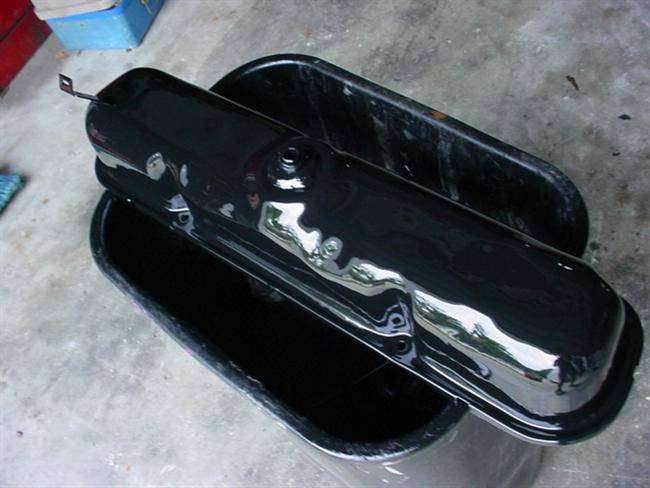

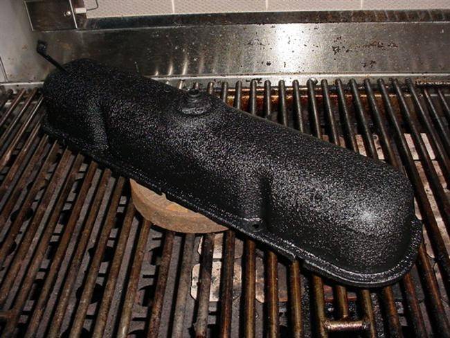

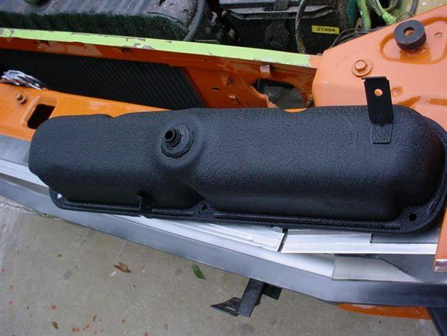

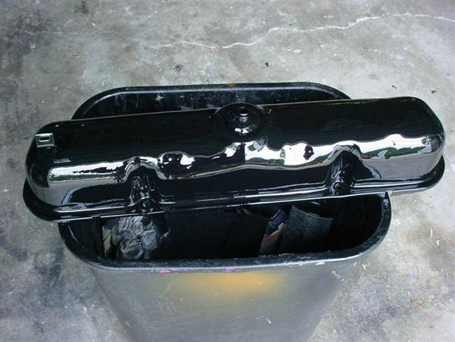

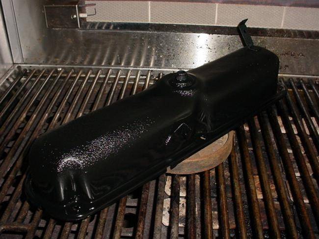

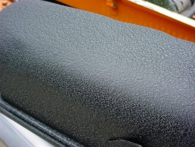

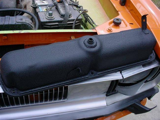

Here are some pics of my valve cover that I wrinkled painted.
Spray it heavy and cook in the grill for 50 minutes.

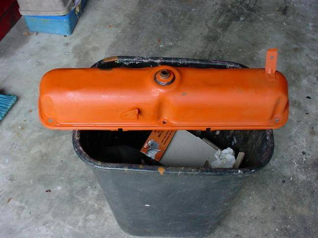

This is different haha. What i meant to say is the car originally orange. What is the original color? While orange in an already orange engine bay is overkill, I think I would of still left the engine orange. I just love the look of that wrinkle coated air cleaner over an orange shiney engine haha. I really like how you have replaced all that metal. And the dash looks sweet. I'm guessing the easy off was an idea from modeling? Keep up the great work.
It was dark bronze. The car came from Canada and had been worked before I got it. All the repair work I have done was painted over but really starting to show. It was green when I got it but am changing to Go -Mango/Vitamin C.

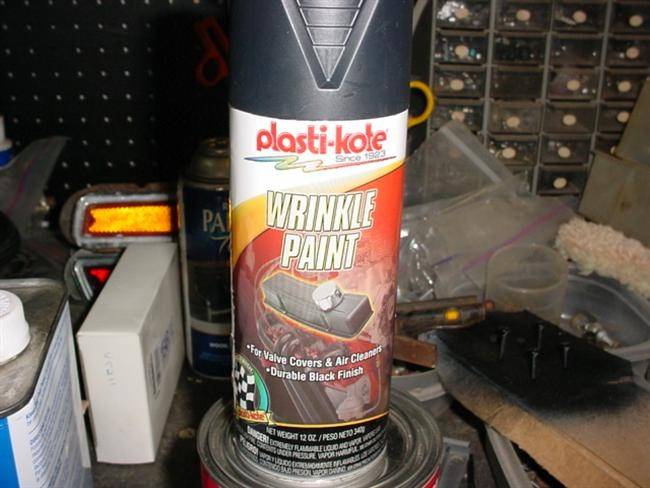

What was your trick to get the wrinkle paint on so heavy without getting any runs?
Luck. 8) It does have a tiny area were it wanted to, but it cant be noticed.
I spray 1 tack coat and then 2 good cover coats and then the final wet look coat, letting it set about 5 min between coats.

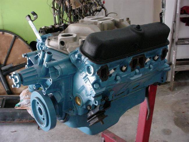

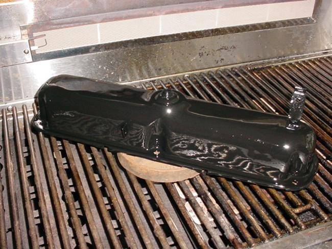

Just did some cosmetic stuff. Painted the other valve cover and painted the heads. This will get them off the shelf and give me some extra room. Plus it's one more thing done. :toothy7:

I just set everything on for now to get it off the shelf. I still need to paint the intake edge of the heads.(Brain Fart)
