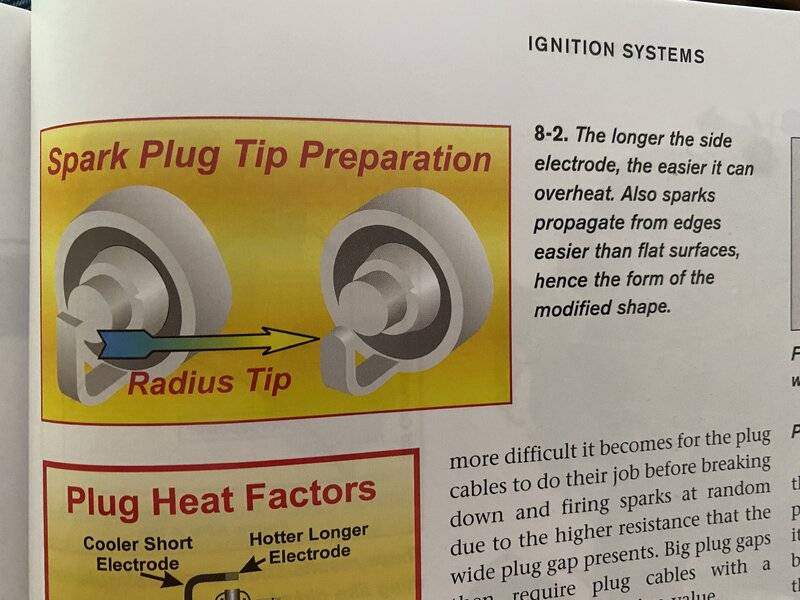

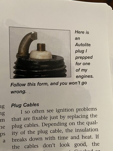

David Vizard in his book “How To Build Horsepower” mentions using Autolite Racing plugs and then grinding back further the ground electrode, as well as doing it on regular plugs. I dabbled with it as well as indexing them but geez, there’s enough things to do elsewhere already. Screw all that. Like I mentioned before I just use Denso Iridiums vs doing all that work:rolleyes:
