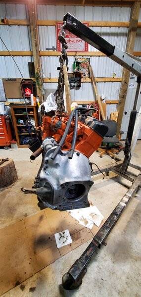

So I need to pretty up the motor (obviously) so there's about 50$, rebuild kit 200$ is step one, engine will be apart so what needs done Internally should be done then at that time. What I'm getting is I should get a mild cam, and a good 2 barrel? Would a 4 barrel and intake make a big difference? (Big enough to spend the money on it?) And that's all before even getting into the electrical bits. Spark plugs, electronic ignition stuffs, coils/wires and what not. Would pistons be worth the consideration? Would my 2 and a half inch exaust I currently got work if I make the headers on the 318 hook up?

I've never cammed anything before and this is looking alot more complicated than what I'm use to, or knowledgeable on... for now however I still have to get the engine in my workspace and clean it. Could be another week or so before that unfortunately due to work :(

The OP is getting a 318 and it needs rebuilt?
That's a LOT of money.
Might be cheaper to get a running driving (but may have trans issues) 5.2 and spend the money on the conversion accessories.
Sure will have an HP advantage right from the start.
In fact, a 5.9 will already be at that magical 300 HP number with ZERO mods.
...and should be good for about 200,000 total miles or more.

I agree though if that 318 you found actually needs to be rebuilt you should just hang on to it and go find a running 5.2/5.9 Magnum to swap in. You'll be thousands of dollars ahead. I've been down that road myself lol which is why the last engine I put in my Duster is a junkyard 5.9L Magnum short block with nothing new except rod bearings. Then I spent thousands on ported aluminum heads, cam, intake and headers instead :D
The donor vehicle that has the 318 in it looks great, what’s happening with it? Do you know how many miles the 318 in it has? Opinions will vary on wether or not you should try to get it to run as is, but I would probably opt to just long enough to break the gum out of the rings with some Berryman B-12 down its throat and running a compression test afterwards. The engine may not need taken all the way down for a full rebuild. If it’s a hydraulic roller 318, it’s easy enough to add a set of magnum heads with pushrods for oiling and an aftermarket carburetor intake and distributor. Most hydraulic roller 318s I’ve seen already have lifters with the pushrod cups drilled for oiling through the pushrods.
