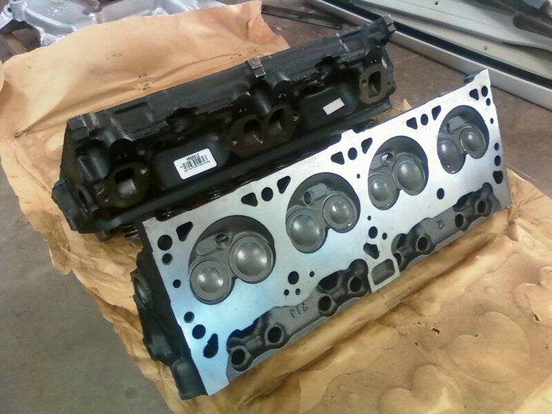

Just curious, why would you go with magnum heads over the 302's it's already got?
Magnum heads will have bigger valves and ports, and will flow more than the 302's. I always hate giving up the rocker shafts, but something gives, right? lol Also, unless you drill them for the LA bolt pattern intake, you are kind of stuck with the air gap... unless you are really patient for the old M1 dual plane. But i guess I'd just take the entire magnum engine.
You also gain 1.6:1 ratio rockers in the switch.

Ok start saving for heads.

Yep! Even the late seventies to early eighties standard duty open chamber 183 smog casting 318 has a better looking intake port.
Terrible amount of shrouding, terrible.
Once they do flow...you realize you could have spent barely half that time on any of the open chamber versions and better numbers. The novelty is how terrible it is from the get go turning out any decent numbers at all. Theres no testing out there to determine if that chamber once massaged is more beneficial than the early closed version.
There are cult followings for everything..and they hate hearing that anyone reputable talking down on their iron idols
