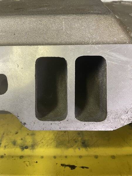

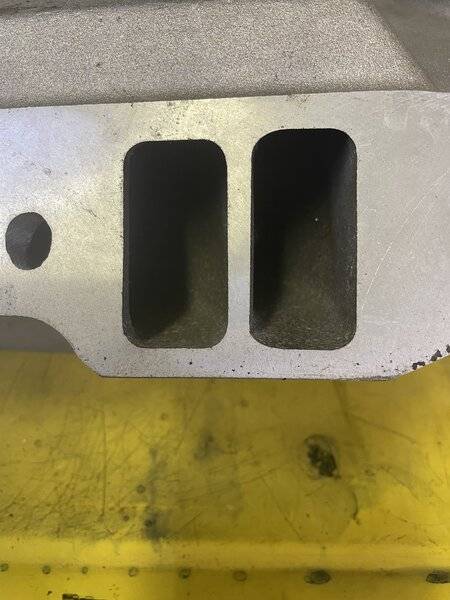

Anyone ever notice how bad the Edelbrock LD4B's are? I have two or them and the ports look like that, plus the ports are shorter and fatter than the 273-318 intake gasket. So their bad quality goes back to the late 60's and early 70's. I have quite a few Holley intakes, their castings most generally look really nice, their port windows are straight and the same size as the gasket. I believe they come from the Winter's foundry, the foundry that cast most of GM's aluminum intakes, Every one of those that I've seen, always looked nice also.

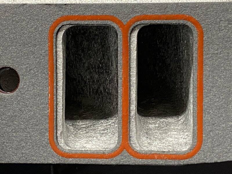

Ohhh well sometimes you gotta know when to take a break. Doing enough of these I know where to place the gasket to scribe my lines but I use 7/16 bolts when I can to center the gasket. Well when someone self grinds the holes for more bolt clearance at all different kinds of angles it really makes things fun. Then when they stick it in the mill to grind the top of the manifold so the valve covers don’t hit now they took gasket sealing surface that I need to raise the port to where it should be. Please Dont do this guys. If you need more clearance just flip the manifold over and hand drill bigger holes.

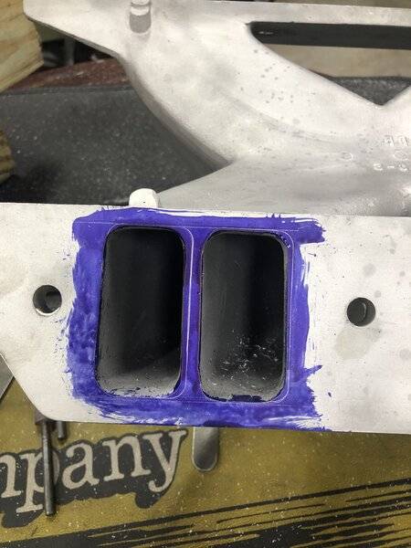

Ok guys what would you do. This is where the port should be but because the top was milled off you can see how much material is left. I wont rely on that to seal and have a couple ideas. What would you guys do. The thin area is the top of the port. The best area to have.
What I would do is, Sell the intake to someone running 318 heads and look for a good used intake.
Exactly what I'd do as well. Too much work and will look boogered unless more time is spent dressing up the welding. If it were a rare or already well ported intake then fix it.

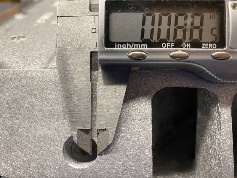

When you order a new Victor 340 you can expect something like this. Having to elongate the bolt holes (about .090” here) in order to slide the intake forward (in this example) in order to line the runner dividers up with the head/gasket.
