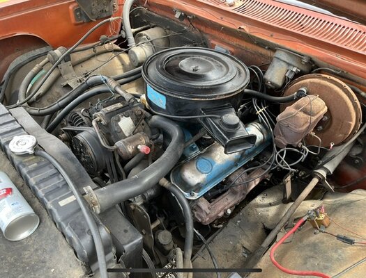

So this thread I will be using to document my progress through the truck and ask a bunch of questions along the way, the first few posts will be catching up from buying the truck to now, I’ll use this first one to just introduce the truck and it’s back story..
So I’ve always some sort of old car or truck to tinker on, my wife is very supportive and also loves old trucks. We finally moved out from the city back in ‘21 and decided on picking up an older truck to use to make the hardware store runs on weekends as my work truck has a topper on it. After scouting around for a while we found the right truck in Oklahoma City..
It’s a 1973 Club Cab, first year for it! The guy I bought it from had, supposedly, been using it every other day until he purchased a new truck to replace it. He had purchased it from its long-time owner of around 40 years, it came with paperwork all the way back to the build sheet, manual and salesman’s business card up in Colorado. With how complete it was and the documented history we went with our gut on it and brought it home.
Turns out, it had probably been sitting a lot longer than we were lead to believe so its become a little more involved getting it to a useable state. We did discover a lot of fun little coincidences with it though, it’s originally from Denver which happens to be where my brother lives, the long-time owners name was a combination of mine and my sons names and it’s been known as ‘Rosie’ for most of its life which was one of my best friends childhood dogs we played with all the time as kids.
I will make my next post about the initial troubleshooting and how the truck is running right now. Looking forward to getting some proper Mopar knowledge and getting this truck running how it should be!

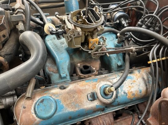

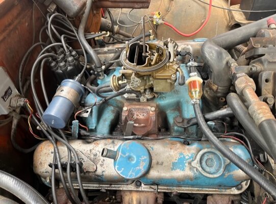

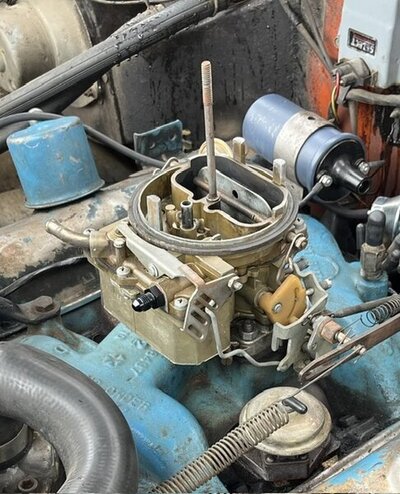

Depends. What carb do you have? Post a few pictures. No need to get a new distributor just yet, you might just need a vacuum can. And let’s start talking in actual numbers here and narrow down the timing. What is the initial timing and what is the idle rpm? What is it at 1500? 2000? 2500? And so on. What rpm does it stop advancing at? With that info someone like @Mattax can plot a graph for you. All of this should be done with the vacuum advance disconnected and plugged.
Just skimming through. It sure looks like an EGR valve on the intake. Off the top of my head EGR should be closed off when the engine is cold, at idle hot and cold, as well as at wide open throttle. Typcially they use a ported vac source and some sort of thermal switch usually in a coolant. vac diagram should be (was ?) in the engine bay. Some used a venturi vacuum signal. example diagram of venturi signal system

Knowing the engine has smog stuff on it, would want to see the carb and check the FSM or Sun cards to see what else it had. Generally trucks has less junk added to them compared to cars of the same year. Shop manual (cars) shows smogged 318 ought to be around TDC to 2.5* at 750 rpm. But that only works at higher rpm with the matching distributor curve. An earlier 318 with its distributor will be more like 5* at 650 rpm. Measure the rpms vs timing and we'll graph it.
Here’s the best picture I have right now for the carb, I’ll snap some more next time I have the hood open as there’s a few other things the service manual doesn’t offer much guidance on.

That’s a Holley 2210 style carb. You’ll find diagrams will all of the ports labeled
Here;
https://www.carburetor-parts.com/assets/manuals/holley-2210-2245-rebuild-manual.pdf
Nailed it, I knew it was a Holley style and started with a 2 but so many variants! I’ll dig through that link. Thanks!

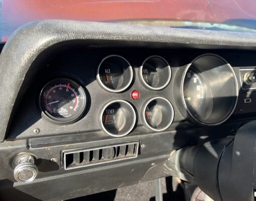

I grabbed a universal 2.5” tach from the local parts store, it’s a hair too small so I had to mess with it for a while getting a setup together to make it fit the factory hole properly. It still need some fine tuning but functional for now..
So my idle in park sits right around 1000 after the choke has finished backing off. In gear it drops to closer to 500rpm and seemed to have a little miss to it so I think I’m going to bump it up 100-200rpm.

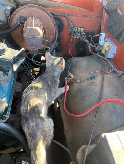

While I was tinkering on wiring I was also joined by, I guess, a neighborhood cat..
Super friendly cat, seen it a couple of times now so my wife named it Maggie. Got to admit I’m happy to have another mouser around with how much the truck and my Mustang sit idle!
