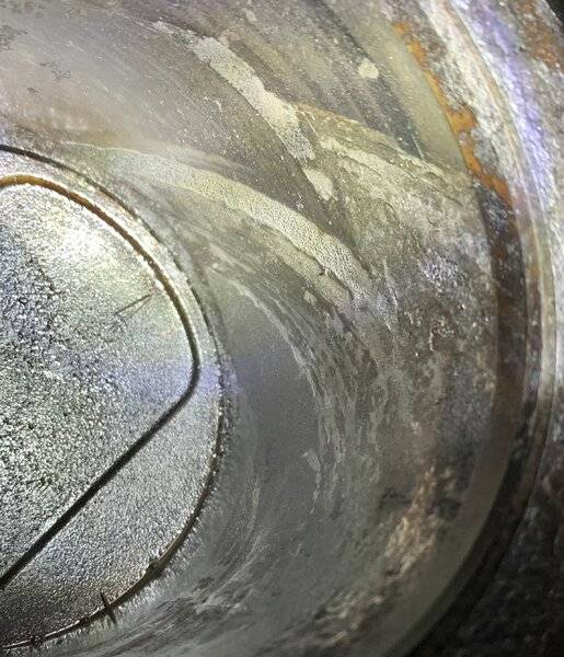

Changing the valve seals and head gaskets was going well today thanks to the helpful people here, but then I removed the other head. All cylinder bores still have crosshatch, one has extra.
I would like to pretend I didn’t see it and continue because having the block machined is not in the cards. I’m spread thin.
How bad is it?
Can I send it?
Will it run bad?
Lose too much compression?
Would this have been evident while the engine ran? …like did I get shafted? They said the truck ran awesome, It was pulled when I bought it for $800 with 70k on it.

That is nasty. From what I see an overbore is necessary. (to be fixed right) I would have to see it in person. Can you catch a fingernail on it?
I really can't see what you have there. Clean the carbon and residue off with carb cleaner or something, oil it down, and post another picture.
Doesn't look great, but pictures can be deceiving- only you can see it first-hand.

Well, I guess you answered your own question. Clean it up as good as you can (lotsa WD40 and a Scotchbrite pad?) and see what it looks like. Maybe even let that cylinder soak in some ATF in case the rings are stuck.
Then start saving your pennies.
You can definitely catch a nail. The upper half is basically fine. I scrubbed inside with mineral spirits and a clean rag before the pics. Can I use fine sand paper in there?
There was evidence of a little water in the oil, and what you said icetech makes sense with how it looks in the cylinder bore. I will try for better pics after my beer run lol.

The engine turns, unless you mean the rings are stuck to the piston?
The problem with water damage isn't the water. It's the contaminants in the water from the oil and fuel and combustion. Acids. Those acids can eat away at the cylinder where the water sat and make it porous. This isn't rust I'm talking about. It's acidic corrosion. You need to inspect it very closely, up to and including complete disassembly if you intend to use that block.
Do not use sandpaper. Most abrasives will break down and leave material behind so you have to be very careful how you attempt to clean it up. A good crocus cloth that has the abrasive bonded to the base cloth material is probably the safest if you are gonna do something like that.
I think I’d leave it be and just get the crust off and run it if you’re adverse to boring it. If the others are good you could just fix the one cylinder.
Real simple, to do it right it comes apart... But if you have no $$$ you run it & hope for the best... What's the worst that could happen? It runs on 7 cylinders? Lotta cars out there running on less...
I got a couple more pics. Water sat in there for sure, the lines are horizontal to the ground. It definitely is acidic damage to the bore, it’s pitted. Everything else looks good as far as I can tell. Didn’t pull the pan yet.

Okay yeah, no way that “was a runner”
Only sitting with a ton of water in it could cause pitting that bad.
If I was you I’d find another block. They are too easy to find to mess with the one you have

Exactly as I described. You can see the holes in the side of the cylinder. That's got to be bored. If you're lucky, none of those holes go into the water jacket. If they do, you'll need a sleeve.
Damn! That looks deep…
Something to consider: Despite how bad it looks now, you may be able to bore it and save the block. But you won’t know until you pull it and check.
However, running it this way could almost certainly cause even more damage, and probably to the entire engine, should some of that **** get in the bearings and/or oil galleries.
I hear you on the money thing, but it’s gonna be a HELLUVA lot more expensive to fix it if you run it as it is, in my opinion.
