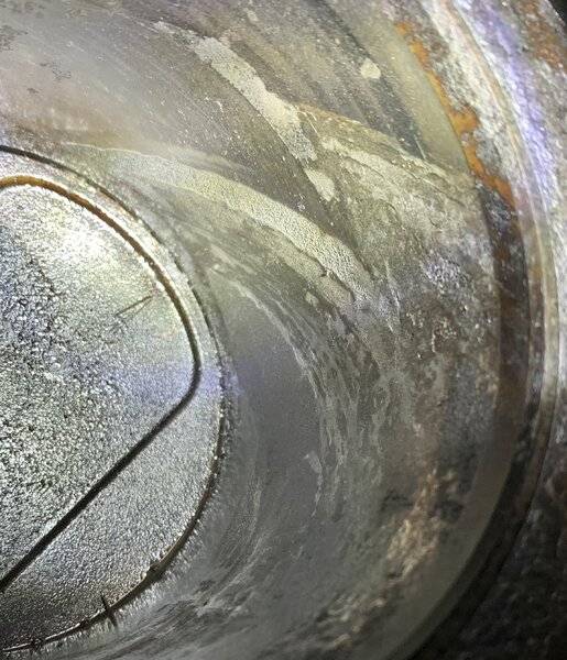

Cylinder bore is scratched up!

I got a couple more pics. Water sat in there for sure, the lines are horizontal to the ground. It definitely is acidic damage to the bore, it’s pitted. Everything else looks good as far as I can tell. Didn’t pull the pan yet.
The 70k engine plan (A) was reseal and convert to carb and roll by late May. The reason I paid $800 was for the millage, 1 owner, garage kept, synthetic oil for it’s life, show truck. I would have never bought it if I knew the cylinder bore was roasted. If you saw my cam thread you know I’m already at the edge of my ability.
I’m not sure how I will go forward, or if I can. Any ideas, input, and experiences are greatly appreciated. My first idea is find another short block, in terms of the cheapest resolve.
I’m also curious how it would run if I smoothed it out slightly, and what the repercussions are. I actually don’t like that idea, and I am very much the opposite of half assing anything, but money is a thing here. On the bright side, you guys are responding to my whoas and that’s fcking awesome. Big thanks! Wish I could return the favor lols.

Yeah..., i do some shady **** and i wouldn't run that.. honestly unless you love that motor for some reason i would hit marketplace and find another if money is that tight.. BTW.. get a $20 bore scope from amazon and take a look in the cyls if you look at another.
Did a some photo enhancement to get a better look at what is the extent of the corrosion in that cylinder wall.
That "White Loop" in this picture appears to be the upper water line, like there was a cup of water sitting in there for some time.

That white loop water line is the upper water level where it sat in that 45° bank, hence the angled line of corrosion.
Pictures and the light reflections in the photos can be deceiving as to how bad it is.
Would get in there and clean that out a lot better to remove the optical distractions. So much so with some 180 git by hand on those bad areas, then follow up with WD-40 and the new red scotch bright pads to clean it all out.
Those red scotch brite pads are pretty sharp, will help to clean it out better.
Then take another look at it.
Don't touch it. Don't do anything more to it.

Until I saw your last picture I was going to say that a couple of light strokes with a cylinder hone is the best way for me to read a cylinder wall............but unfortunately that bore doesn't look salvageable with pits that deep.
One suggestion on scotchbrite - I never use it on internal engine surfaces unless it can be thoroughly flushed. It leaves way too much easily embedded abrasive residue.
The surface is very uneven below the water line, and the water line(s) are deeper and pitted. It’s worse than it looks, when you touch it. I don’t want to use it anymore since repairing it will cost more than finding one that isn’t toasted.

I called a good local machine shop, he said 300 total to sleeve it, but it usually knocks the next cylinder out of round, and it snowballs.
I won’t touch it, until the owner makes his decision, but I also won’t be strung along.
Hopefully this isn’t the old switcheroo, because it does sound like it.
He's right, too. That's why you sleeve first, then check the two adjacent cylinders so that you can figure what their bore needs to be and proceed from there. Hopefully, you get this resolved to your satisfaction.

That engine is pure crap,,,,and someone knew it ahead of time !
Look how bad the intake valve for that cylinder is rusted in the pic !
800 bucks was way too much to start with,,,unless the engine was perfect .
