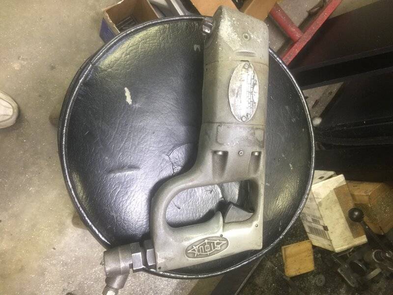

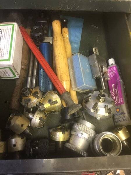

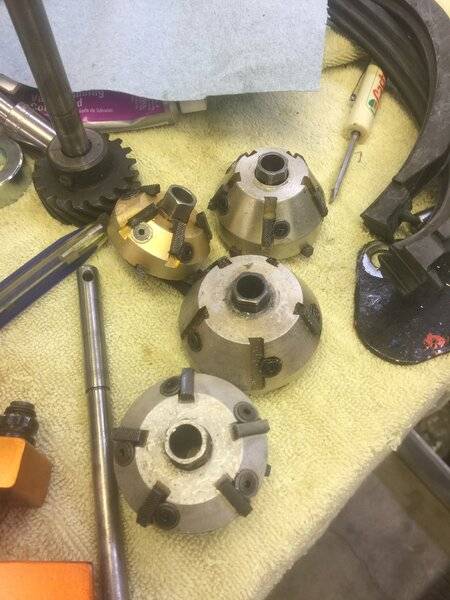

No pretty but it works great. I bought new tapered rollers for the valve holder (no cheap) from Goodson five years ago. I would use my stones probably more if I would buy a new stone holder. I have a link saved up in the house on my desktop if any of you guys need one. I comes highly recommend by some top notch guys. A few of my Neway cutters.
View attachment 1715533585 View attachment 1715533586 View attachment 1715533587 View attachment 1715533588 No pretty but it works great. I bought new tapered rollers for the valve holder (no cheap) from Goodson five years ago. I would use my stones probably more if I would buy a new stone holder. I have a link saved up in the house on my desktop if any of you guys need one. I comes highly recommend by some top notch guys. A few of my Neway cutters.
Oh! I have the exact same valve facer
! lol
Scored mine from a business I once worked for.
They hardly used it.
