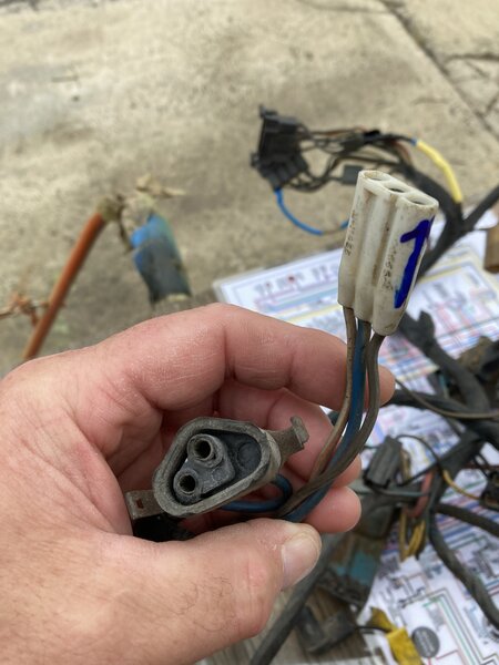

Does anybody know where these plug into?

I’m trying to find the wire that goes to the starter post. I don’t see plug for these plugs.

Well, uh, you are going to have to go look at the emblem on the hood, and figure out what year, make, model you are working on, and "does this appear" to be factory wiring?
Exhaust gas recirculation timer located on cowl top right side.
Electronic speed switch (catalytic converter) located right fender side shield. They may have been removed by previous owner.
3874300 - exhaust gas timer.
3874210 - speed switch.
Emission control devices.
If you're talking about the starter relay nothing plugs into, all the wiring there is screwed under terminals. It might be part of the stupid seat belt interlock wiring.
I don't believe 75 had that, only 74

To clarify the diagram show a wire connecting to the starter relay and goes to the starter motor. But my wiring goes to the plug with the blue arrow. The only reason I know this is cause I used an ohm meter to check where the other end came out.
It plugs into the box that is or was next to the voltage regulator, as seen in this photo.

triangular plug is for the VR
J2 is ignition-run
k is the segment 14 is the gage and DBL is dark blue
J2 all segments connects together.
I appreciate all of the replies. Does anyone know what wire goes to the small terminal on the starter? I can't find it on my wiring harness.
That wire is a no12 or 10 and goes from the starter (small) solenoid terminal to the "square" screw terminal on the starter relay. On factory original battery cables, it is incorporated into the positive battery cable
