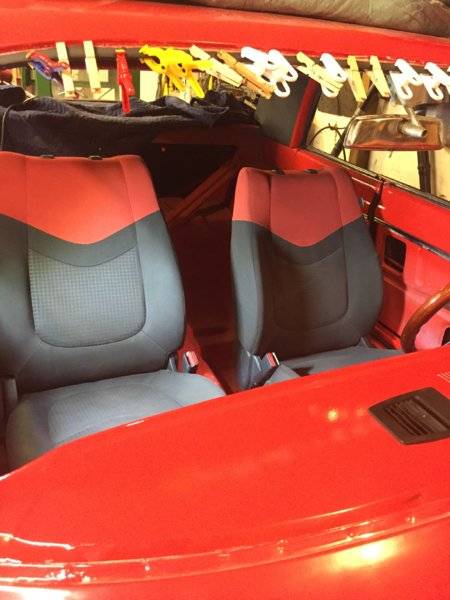

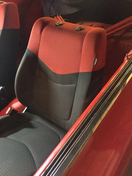

Picked up some seats for Jason's car. They are from a 2009 Kia Soul.
They are the perfect color combo for what we want and really comfortable.

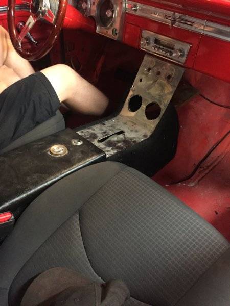

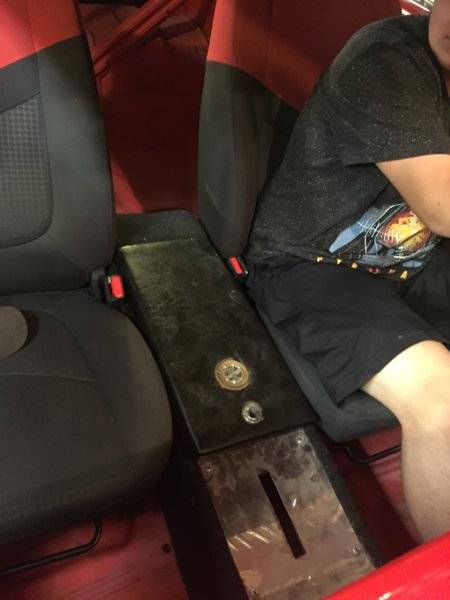

We did a test fit of the bucket seats and my old center consul in Jason's car. The center console came out of a 1963 Chrysler 300 J. I had it recovered for my Valiant 20 years ago.
They fit like they belong there. We're planning on finishing seat mounting and fitment on Wednesday.

Fabricated the mounts for the seats. It was fairly straight forward.
They fit great. Now we just need to fabricate a new top plate for the console to fit the shifter and the gauges.
Close up of the round tube we used to modify the mount to fit the curvature of the floorpan.
