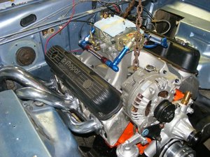

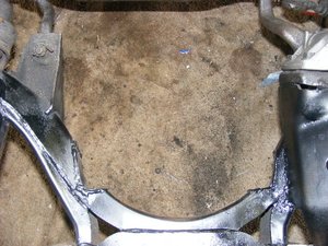

Let the fitting begin!Today lowered the engine in for fitting the fenderwell headers.I got it in,but need to notch my K-member for the Mildoon pan(clearance)I,ll notch it out and box it in.The best investment I made was buying my Lincoln Mig welder(with tank)before starting this project.:-DNow back to trim and fit..:cheers:

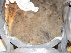

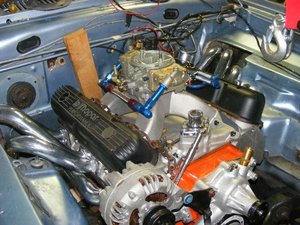

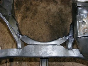

Today I notched the K-frame to make room for the Mildoon oil pan, also trimming more for the fenderwells(what a task)I need to open up the K-frame alittle more(the pan fits but is too close for my liking)now to fit the driverside header.Enjoy the pics

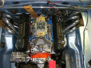

Today I had to cut open the notch job and redo it(was still to tight)got it done.Also fit the d.side header today.My axels should be here next week,I also need to get a SFI approved,7/16 INTERNAL balanced flex plate,6 bolt for 904.I also ordered a universal pully that I need to have machined down for pully alignment.Dam ATI dampner!:angry7:Might aswell start the cage while I wait for parts!:toothy10:

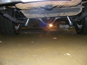

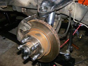

I got my Strange Axels late today for my shorty rear and have to have the green bearing pressed on.Atleast I can get the car back on the ground and moved over to get my other car out from behind the garage.Nice weather coming again(was in the 80,s all last week)I,ll be glad to get the rear all buttoned up and done.Still lots of work ahead!:clock:

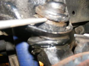

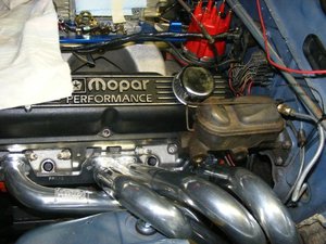

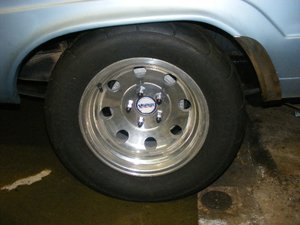

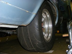

Well I got my rearend all back together and also had to weld on my e-brake cable brackets(from cutting the frame)I have a pair of M/T drag radials 275/50/15 (26 inch)on 10 inch rims,so I might aswell use them up.I also replaced my upper ball joints and tac-welded in place(threads getting worn)also replaced outer tierods and sleeves.Engine/Tranny/t.convertor is all buttoned up,so decided to look at my M.cylinder.It looks very close,maybe a smaller one?Any help with this would be appreaciated.Thanks.
P.S Lots of room for some 28 inch tires!
