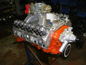

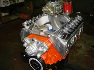

Well today I went and threw some more money down on my 408(410)it should be coming home by friday,also my headers should be in tomorrow.WooHoo!Everything is falling into place with parts and delivery.I,m about to start my rollcage this evening,should be fun?My shortened rear is also going in this eve,waiting on my axels from Strange.Man I gotta make a new list of things to put back on/in.I,m gonna be a busy-boy for the next few weeks.Couple pics of my solid roller cam 408.:cheers::clock:

Been following along with your progress. That thing is going to be FAST! Are you planning on a hood scoop for that giant intake?
Yes on the hood scoop,just happen to have a spare dual snorkle going on.It,s not period correct but either is anything in the drivetrain.:snakeman:Time to cut the mint hood..:angry7:
Scott that motor is a thing of beauty, . What about a glass hood? I know it's more $$ but at least you can keep your stock one on the shelf. Remember if you need an extra pair of hands just give me a call or PM me.
Yes please consider a glass hood. Don't cut a good stock one :-D
I know VPN makes a lightweight unit

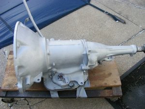

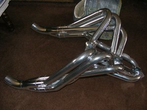

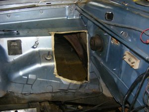

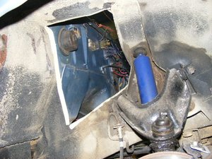

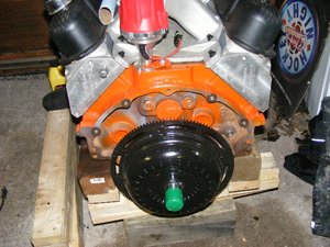

Well picked up my motor today!It,s home!My tranny is here and my 4500 stall Coan t.convertor,fenderwells showed up yesterday.So today I did some measuring and made the cut!I could put this all together but I need to find a SFI approved,6 bolt flex plate for a 8 inch t.convertor(internal balanced)?Any ideas where to get one?Thanks,here,s some pics..

Can I use a 10 inch flexplate with a 8 inch convertor?I checked Summit,Mancini and Coan.Nobody seems to have a internal flexplate for 8 inch convertor.I,m stumped.:stop:
