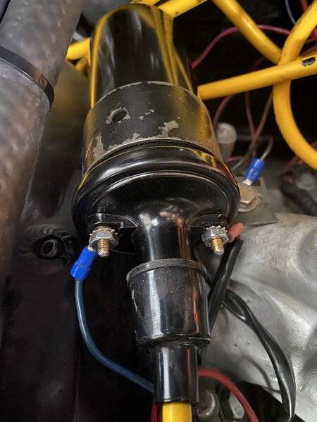

So I’m charging the battery then I’m going to check for myself spark from the coil wire. One thing I notice is when I turn the key off after trying to start it, it gives one cough out the carb with fuel. Possibly ignition issue then?
So I pulled the wire from distributor to coil off at the distributor and laid it on valve cover to see if it sparked and it did not. I’m confused because it runs intermittently. Is the coil going bad or something else? I assume check the cranking volts at the + to the coil?

Check coil POS with key on in "run" position, engine stopped. With battery near 12V (not undercharged) you should see anywhere from 6-8 V to coil, not much more. This shows that the coil is drawing current and through the IGN box to ground
Coil + when cranking "with the key" should be "same as battery IE 10.5--11V or so

So I’m working with what I have which is a test light. It is my understanding that connected to the negative on coil, touching the test light to the positive, the light should flash. It did flash. I took spark plug #1 out to see if it was getting spark. It was not. I checked with the test light at coil, light on but no flashing light at crank.

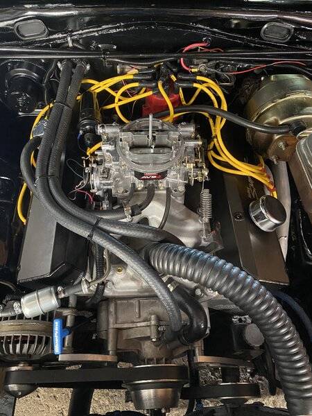

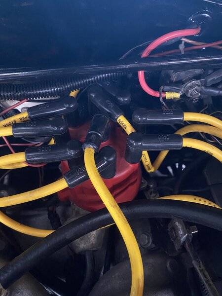

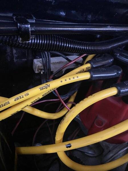

I would start checking poor, worn, weak connections at everything. Bulkhead connector, ballast resistor, starter relay, battery terminals. Just to name a few. Also pictures speak volumes. It helps to see what you’re working on.
