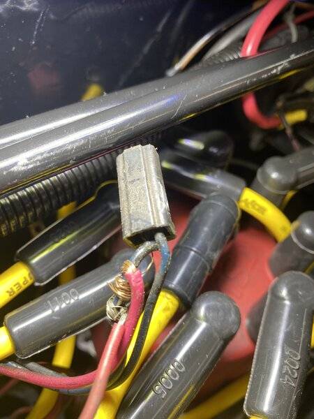

So I fixed the ground from coil that was shoddy. Then I saw the ballast resistor connection from the driver side had very old electrical tape on it. I dug into that to find a real gem of wiring.
The two wires added on are a power to choke, and a power going into plug for distributor. Working on fixing this now.

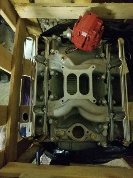

So I discovered my motor originally came with a gm style hei distributor however it was too large to fit in my engine bay so the msd distributor was used from my prior motor.

That’s the engine that is in my car now. I talked with blueprint and discovered the original crate motor had the gm style hei distributor in it from blueprint. It was too big to go in my engine bay so the msd 8388 was reused from my last motor. Josh from blueprint has been walking me through the timing specs for my motor(mechanical advance only w/no vacuum advance 34*all in by 3500 rpms). Also have msd blaster 2 coil otw that recommends no ballast resistor. This wiring has 55 years of “fixes” and I’m about done with trying to figure out all these brittle wires and where they are supposed to go, and how to bypass this plugging what wire where. Frustrated

This problem has been resolved. The wiring from when this motor was installed was a large issue. The mechanic who installed it, was responsible for the cob job wiring in the picture in the post above. I also changed the springs in the distributor to bring mechanical advance all in at 3500 rpms. Timing is set at 34* total at 3500 rpms now.
