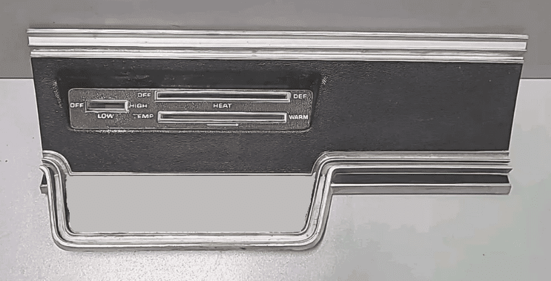

all GT faceplates will have the lower portion that the radio would go through. EVEN radio delete had that but no holes for the radio
poor photoshop of heater delete GT heater bezel BUT it is what it looks like.
I have seen 1 GT heater only Radio Delete plate in 8 years on the internet looking for 67 Dart parts. AND yes I should have bought it!

your best direction is to get another 68 heater radio bezel and then cut out the radio opening parts and make a black face plate to fit the basically rectangular area. Then cut out an opening for your AC vent/s
I think the only rarer part would be a 67 GT AC/ Radio Delete bezel (if they made one)
