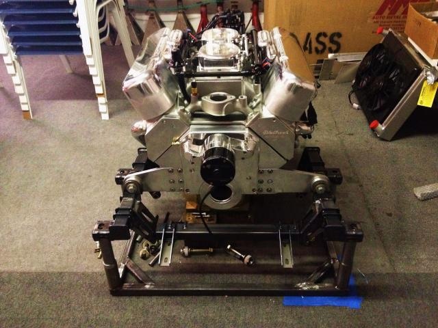

Heres my new HDK that Denny dropped off last Saturday. I ended up making another set of motor mount K frame brackets due to some final fitment issues, basically I had a had a brain fart when I made the other set of brackets for the mock up..... but Denny helped me see the error of my ways when he dropped off my new HDK. Now that the 9/16" attachment bolt slides thru like butter it's time to ship it off to the local Powder. Hope I made you proud Denny, I know your not a big fan of people welding on your Products.
Very nice!
You and I suffer from the same disease as others here on FABO... if it is not 100% perfect, it is re-do time.
Looks great Ross. I presume the stencil on that box says "GLASS".
Perhaps that is box is just tagged for pickup by the Findlay boys.
Anyway. I think it is apparent when comparing Dartn440's HDK to 76Orangewagon's that the
former is the regular version and Ross's is the LA Superslammer? Is my observation correct?
