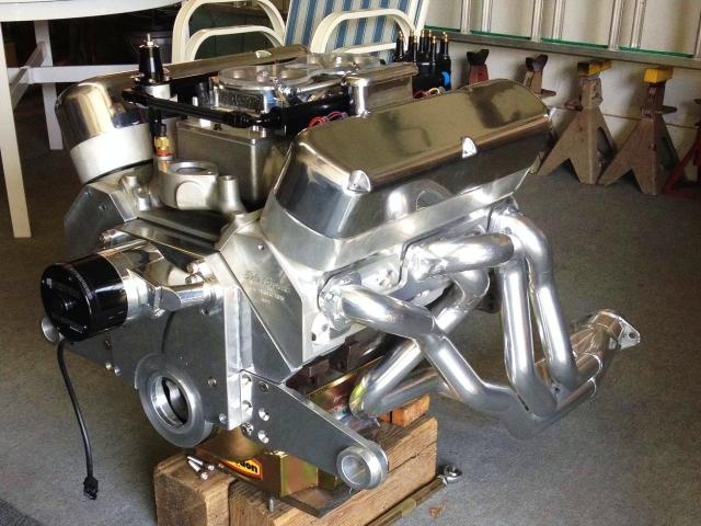

The B body small block header used by Orangewagon fit great and looks racey........unlike the spagetti look of most small black headers....tucked up nice too.
What b body headers did he use?
1 7/8" small block B/E body TTI...if I had to do it over, I would have designed my own not that theres anything wrong with the TTI's although I did have to modify my Milodon Pro Touring oil pan slightly for clearance issues. Heres a picture after I had them Ceramic Coated...I also added Flomaster ball and socket collectors for a little added body to collector clearance since I raised the motor in the chassis some.

I thought maybe something like these Hedman van headers. Long tube so no performance loss. Nice symetrical look without unecessary spaghetti loops. Might be easy to cut and shorten, have them ceramic coated. Thoughts?
What does coating cost?
Where I get them done $240 a set. They look like they would really hang low from the picture. I think the TTI shortys would be great, you could raise the motor more than mine without the body to collector issues I had/have.
