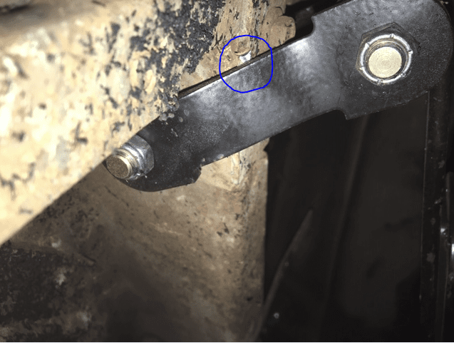

just a thought and probably not the problem but when mine was making a bump as i launched it wasn't the wrinkle wall slick but the off set shackle binding.
