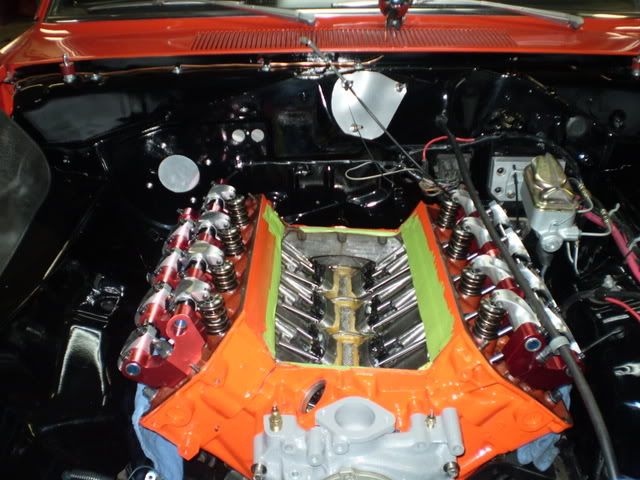

7- smaller steering joint
8 -k-frame spacers
9 -repro k-frame
I went with the most difficult combo with my car.(mopar x-ram (taller that a original manifold)- non x-ram carbs (which require spacers) and I insisted on running air cleaners which made the already negligable hood clearance non existant.
Unfortunately in my situation I had to do ALL the mods and then some!
In addition to modifications 1 thru 7 above I used a stock K-frame and made my own spool mounts (so I could lower the motor)
- Cut and re-routed 3 tubes for clearance on off the shelf Hedman's
- Sectioned and re-glassed a 3/8 extension on a Glasstek stock scoop to make it taller .
I also made my own dolly so I can install the entire assembled motor and trans together from underneath.- I have had everything in and out myself about 6 times with all the mockup.
It is a real lifesaver..
It's slow going as I am doing the ENTIRE car myself - sent out only the machine work and the tig welding for the rollbar.
It's the only way I can afford it - It's the car I have wanted since I was 11 yrs old so I don't mind the wait!!
Be glad to help anyone with questions
