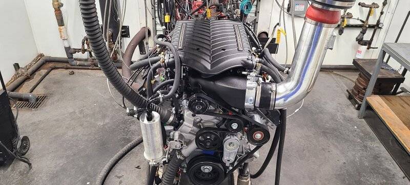

You mean something like this?
That is cool. Looks like it would appear stock if you put a factory air cleaner on it. I think Rat Bastard (or the reincarnation of Yellow Rose) got his panties in a wad when I said that the "shortfalls" when referring to wedge engines. The very next post I made I stated that "shortfalls" really wasn't the word I should have used but, yet, he continues being pissy about it days later.

Like this....lol. "stock appearing" is what I was going for. That's why the coils aren't on the valve covers. I wasn't happy about switching to the fabricated aluminum covers since it takes away some of the stock look, but I was at my wits end with the damn oil leaks from the stamped steel factory valve covers. I bet a G3 doesn't have oil leak problems....
No need to convince me about the G3 benefits. Just as I stated in a previous post that I'll never buy another carb, I'll also never build another LA engine.
Absolutely wicked motor. One of my favorite builds on this site.
