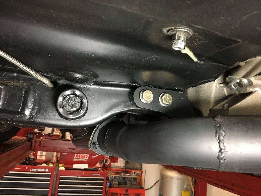

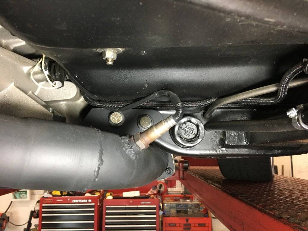

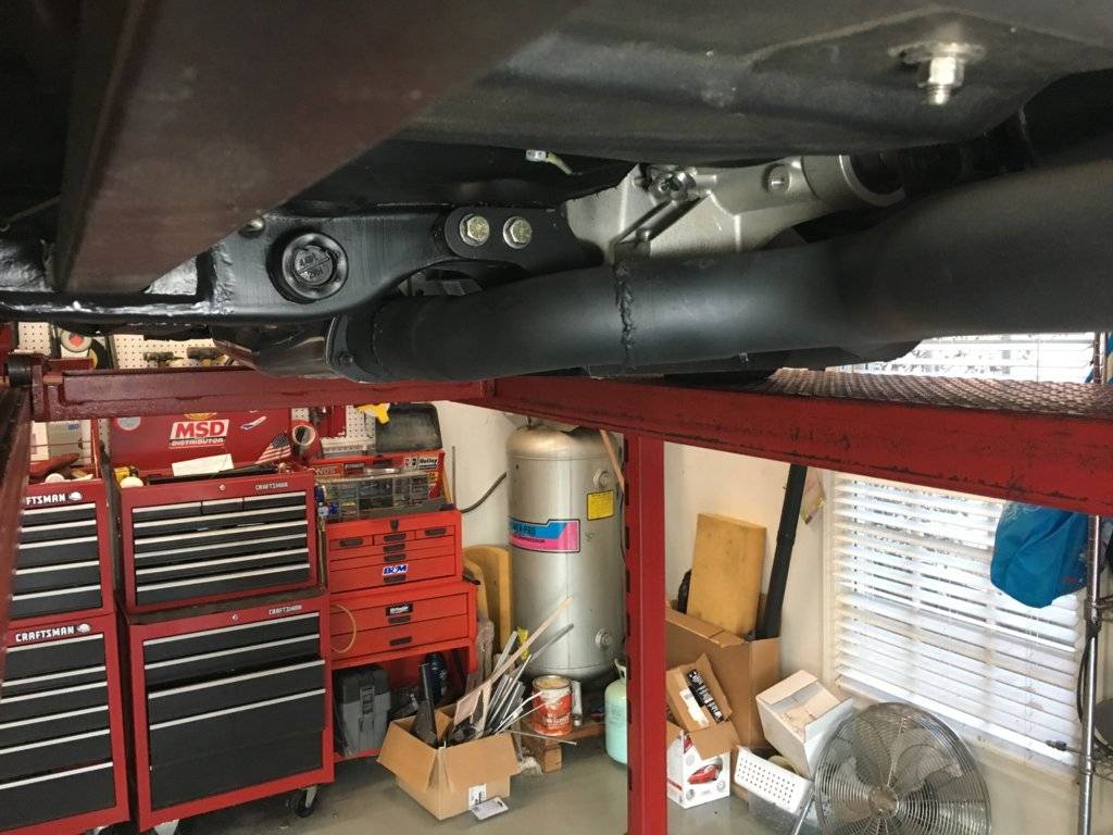

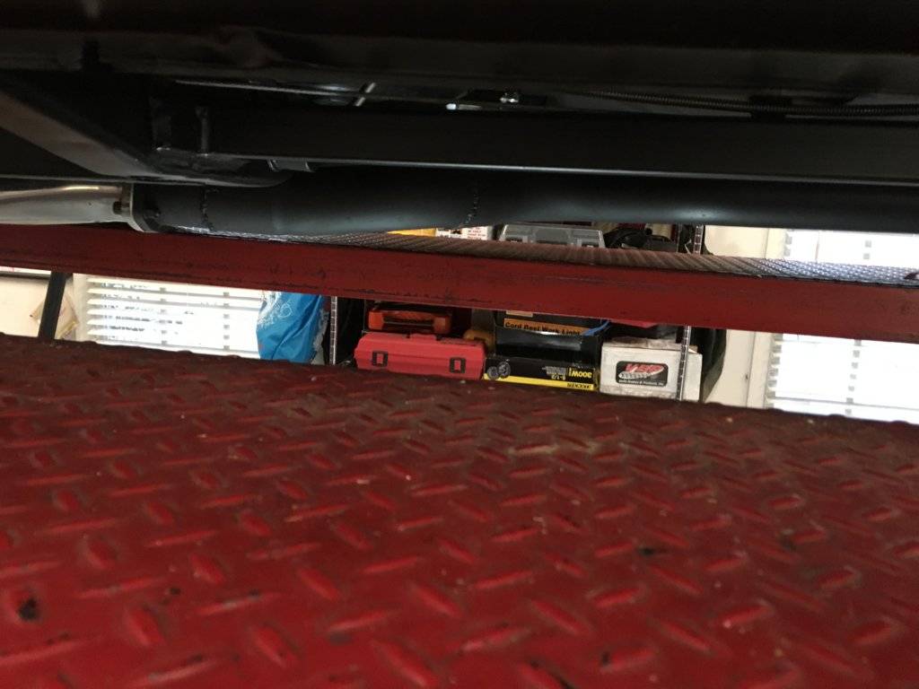

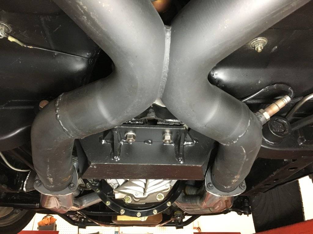

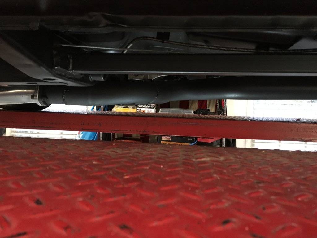

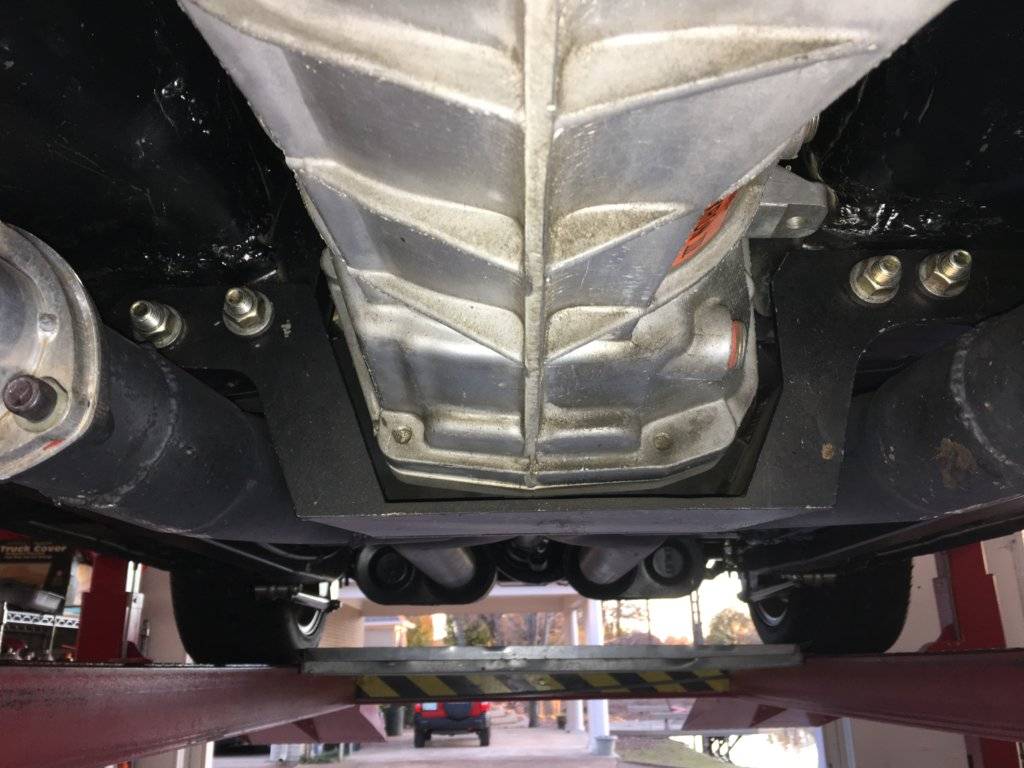

Do you have an exterior side view of the car with the six speed installed?
My 69 seen in the pictures has 2” drop front spindles, and full TTI 3” exhaust. The car is quite low.... and if you look closely.... the lowest part is the header section.
It is a fine looking machine. Looks like a clean install, too.
Oh, and for the record, that 4 X 4 stuff cracked me up.
I was cracking up too.... drop the trans. A couple of inches.... oh my he had no idea!! I have to add also.... the A-body cars.... unless they are something super special will actually be enhanced (value wise) with a transmission swap like this. I really don’t know why some
