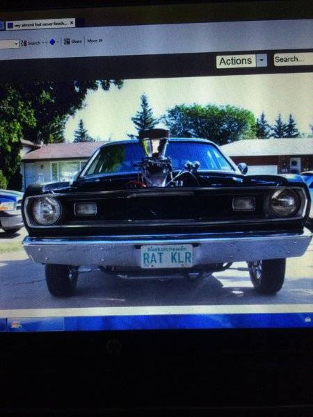

Now it boils down to the 625 or the 750? It boils down to the Chrome and the composite? I've never had any heat soak issues whatsoever with the Edelbrock and Carter carburetor.. I do plan some small 2-in risers just to get the carburetors up where you can see him a little bit above the hood... If you seen the picture the top of them are just below the hood or about the same level.. and yes it's a look thing and no I'm not going to put a stupid wing on the back and get all crazy, I just always imagined a dual quad tunnel ram and being able to see the carburetors... Seeing the linkage moving..
