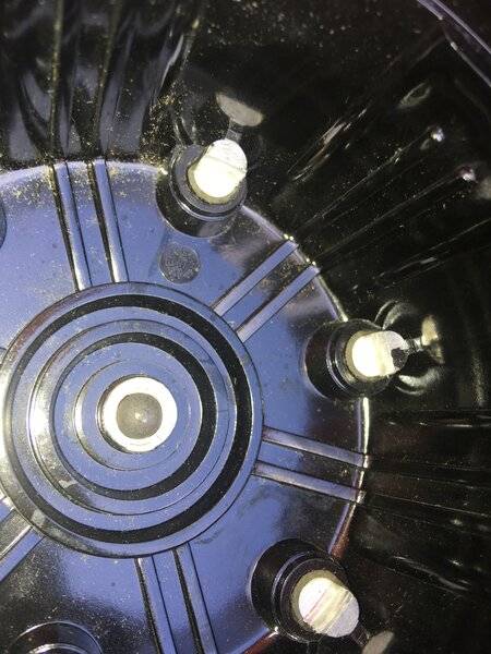

looks like a lotta brass dust in this cap!
Sounds like the rotor is slapping the towers; pop the cap and look.
Yes when I removed the cap the rotor can move up and down by hand. The contacts are all getting worn down on the cap at the bottom of the step and starts to grind into the plastic. Fairly sure you found the answer with that shaft bushing.

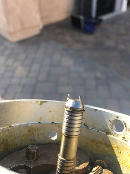

So I removed the distributor today. There was no oil felt. The spring clip seems as if it is the wrong clip or the shaft has worn enough that there is now vertical play. I also found a piece of plastic that I can’t identify. Does this look like the correct clip? Is this shaft worn down?
Sounds like A/J and I may have found it? The rotor fits on pretty tightly and should be pushed on pretty hard. If the nylon gear is still fastened with its roll pin, there should not be 1/8 up and down play on that part, but there is another place to check: there is a spring clip under the felt wick that holds the upper part of the rotor base, that may be missing or maybe not seated as there should be very little up and down movement on that rotor. You see what it can do when it moves.
So I am fairly sure the shaft has been worn down over the years where the spring clip rests which has given the vertical play I am experiencing. Or I have the wrong clip. Now I am trying to figure out if I can order or make a bigger spring clip to fill the gap or if I need to get a new shaft. Any recommendations?

So I am fairly sure the shaft has been worn down over the years where the spring clip rests which has given the vertical play I am experiencing. Or I have the wrong clip. Now I am trying to figure out if I can find/make a bigger clip spring to fill the gap or if I need to get a new shaft. Any recommendations?

I mocked up a bigger clip with a paper clip and I no longer had that vertical play. I guess I just wanted to learn how/if I could fix the problem before I decided to replace it. I am 28 years old and I bought this car because I really wanted to learn about these old beautiful beasts that came long before me. If you happen to have one on hand that would be awesome. One of the reasons I went the Mopar route was the community I saw.
That clip does not have to be tight, the parts ain't going anywhere. I have run my distributor for hundreds of miles without the clip. Far as I can tell, it's just an assembly-line aid.
What you think is wear, or what looks like wear, is not wear; that is how it is made. When it has oil on it, it is a bearing; it only moves a few degrees.

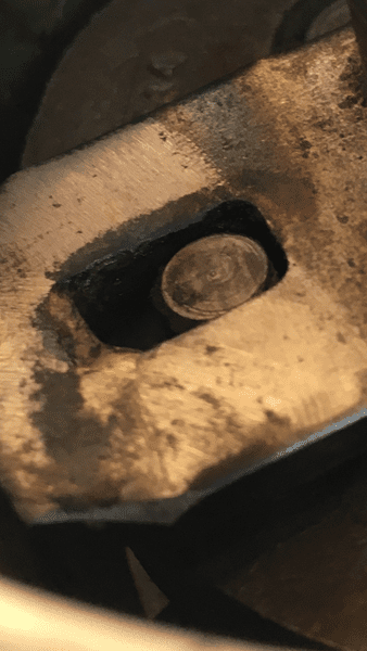

I could see how the breaker plate wouldn’t allow the cam to have much vertical play and I believe you have driven without the clip. That just seems to be the only thing that is allowing any play causing my issue. I thought the function of the clip was to keep the cam in place on top of the shaft and against the governor weights? This is the amount of play I get on the cam in the second picture. Appreciate the input!

From all the pictures I have seen nothing that really points out a problem area, but I have not seen a picture of the distributor gear and its end play gap.

It is. At the distributor manufacturing plant. Once installed, it only keeps the guts together when you pull the rotor off. The rest of the time, gravity and the packaging constraints, inside the assembled unit, keep it all together.
