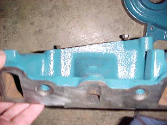

On the Intake,
Most Mopar Small Block Marine Engines will utilize the 'angle-deck'
Carb mounting surface. {see Manifold photo below}.
That Carter AFB Carburetor on the current 273 is most likely a 500 CFM Rating
with a 1 7/16" Primary and 1 9/16" Secondary {Mechanical Secondaries}
I would 'not' use an Aluminum High-Rise {ie; Edelbrock Performer or Performer RPM type unit}
as clearance will be an issue, and a low-plane Intake works better on that combination.
I'll see if I can find a photo of the recommended Intake.
Below is the 'stock' Marine Intake.
The throttle bore openings at 1 11/16" which was called a 'Free-Flowing Intake'.

Youre correct that the marine intake has a built in wedge. When going to an aftermarket intake, its common to install a separate wedge spacer, though the AFB/Eddy is more susceptible to the angle change than a Holley. We have successfully installed the LD4B intake and fit it under the hood- so that is the way we plan to go for these new builds unless the RPM is known to be similar in height. No need to go low rise. We do need to make modifications to the cooling passages to an aftermarket/automotive style intake, but that is something we are prepared for.

Im reading a little more and it looks like 273 marine heads that I keep calling "318 heads" were actually offered on both the 273 and 318. My buddy's boat had 675 castings. (This would make sense since the 675's look to have been installed in later 273's. The marine industry lagged the automotive by a year or 2 back then... our boats with these 273's were generally built '67-72). Is this head chart correct?
http://www.mopar1.us/Aengine.html
If so, then it looks like there is only a 3cc difference between the earlier 273 heads (57cc) and the 675's (60cc). Im reading on here that the 302 heads are ~64cc... so that would be going in the wrong direction, no?
Anybody have a good recommendation on a set of heads that would boost compression into the mid 9's? Swapping pistons isnt on the table (for me) at this time... though my buddy with his egge 10.5:1 pistons is looking smarter and smarter. If my math is correct, I'd need to get down to ~51cc chambers to get 9.5:1. Does such a head exist?
