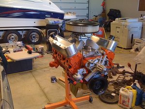

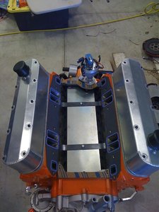

Ok I am not trippin anymore. The heads are on with the Felpro 519 Super Duty Perma torques. .054 compressed thickness.
Was another issue with the rocker gear. I need to use lash caps. Looked like the roller rocker was going to come off the valve. It was using almost the whole valve starting on the base of the cam thru full lift. I just do not trust it so Lash caps are on the way for tuesday. I also had to clearance the valve cover gasket and rail in 2 areas to clear the head stud nut on the sides with the breathers.
Here is a picture of the Mock up with the heads on.

Almost there!
