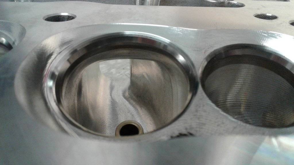

Well the BPE heads are here. They sure look nice, but I was expecting to see something dramatically different. I think I just don't get the "shortside" thing yet.

Here's a few pics from this crappy tablet.

How about a pic of the Short Side looking at it from the valve side, looking up the port.
Splain it to me better, brutha. I'm still not hip on this "shortside" thing. I'm not so sure its different than the Eddys.
You want a shot from the valve looking out the intake runner?
Yup!
looking through the valve seat down the intake runner.
when looking down the port from the intake side there is a turn on the floor of the port that flows down to the valve seat. that is the ss or Short Side Radius.
The best way to see the shape of the SS is looking from the intake valve, backward toward the intake surface.
Take you finger and fill the shape of you Eddy SS and then fill the shape of you new head. you will fill a bigger radius more then you will see in a pic.
But sence i'm not there....a picture will have to do.
Thanks by the way.
I spent quite awhile fingering them. Uh.....don't feel much different. Here's a couple more.
Well...come on, man! I got's 'ta know.....How does it look? Now that I went back out there, the Edelbrock seem a bit flatter. Not much, though. The overall port seems way smoother transition-wise, and not nearly as "bulbous" as the Edelbrock.
the smoother the air can travel the more HP potential it has.
The biggest challenge is to keep the air attached to the SS! if it jumps of the SS it crashes into the valve(turbulence) and turbulence kills performance The smoother, rounder that it is and still have a large enough Cross Sectional area to keep the air speed within reason wins!
Put both then head back on the flow bench and only flow them at .600 lift. You will hear which one is the winner! (Hint turbulence is more NOisE)
This is only my opinion/guess
But they had too much air speed and it was jumping off the SS. So to slow down air speed you make it larger in that area. theY must not have been able to widen it or take more out of the roof........so they cut into the ss.
Slowed air speed down but now you have a smaller (less round) SS. The flow bench### my not have caught the problem......but you're running eng DID. :)
That my not seam like a lot but it Huge. ^^^^^See red righting!
Gotcha. Now I understand the short side a lot better. I was expecting to feel like a half inch difference, so you can understand my questioning. I think I will side by side them tomorrow morning now that I know what to look for.

Holy crap! I HAD to run out to my garage and look again at the Eddys. Man you are right on the money. I really couldn't feel it earlier, but the Hughes SS almost is flat to the damn valve seat!
