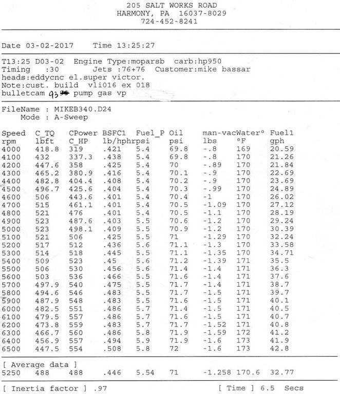

It wasn't a blanket statement as I have pretty extensive experience with the Super Victor, so in this case it is my actual experience that I am sharing. Maybe you should have enlarged your intake much larger than you did, In your case I have never used those heads so I cannot predict what the results would be. Unlike you I DO get extensive R&D time on my dyno so maybe you made me realize I give away too much and I'll shut my trap from now on. J.Rob
Hey, forget that "trap shut" crap. You are one of my sources of higher education.
Okay now, I'm back to just watching.
It was a blanket statement regarding the super victor intake. I'm not doubting that you've found that to be the case with every super victor intake on every combo you've dyno'd. I'm doubting that you've dyno'd every possible combination that a sbm super vic could wind up on thereby making it a blanket statement. I would love to have tried ootb, port matched and oversize intakes with the victor heads. I would have also love to have tried two more cams as I think I missed quite a bit of power with what I had ground, but it's just not practical when you're talking R3 cam cores. Like you, I had never used the victor head before. I'm a nobody, don't let my opinion bother you.
I should have just stayed in "watching" mode, lol. I wish I had my own dyno like you and RAMM... I'd love to do as much R&D as you two post up.
You really can't run a SV out of the box. They come tiny, man. I mean small. They assume your porting so they leave them way undersize.
wonder if there are any dyno sheets that could be found with the super victor intake and similar combo, maybe that's what the torque curve is with this intake??

This was a build featured in HRM a couple years back... using the SV intake with ported Edelbrock heads.
Torque was equally low as Ironmike's build... cam specs were 260/266 Degrees Duration At 0.050 And 0.683/0.657 Lift (with 1.65:1 Rocker Arms). OK it's a magazine build :)

Speaking of W2's I have linked the 416 I built with W2's and Victor 34o W2 intake manifold. @ 4000 rpm I observed 520+ ft/lbs which is almost 100 ft/lbs more than the OP's engine. I have a few ideas on why this engine is lacking and how I'd correct it.
416 W2 on the dyno w/cam swap
