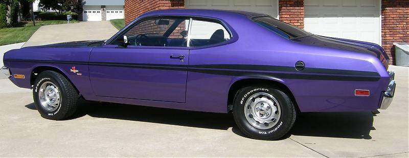

I made some progress today with my Demon. I started stripping down the rear of the car and getting it ready for paint. I put the new deck lid on. I replaced it due to the previous owner hacking it up to install the wing. I now have a factory cut-out lid and the wing will go back on the new lid. I removed the rear glass in prep for getting it painted. Amazingly I didnt bend the trim taking it off. Also no rust under the rear glass seal and all trim clips are like new.

I tore down the short block that I bought in a pkg deal from someone tonight. This was a rebuilt engine. [Yeah right] It looked new. new pistons, recond rods, arp bolts, ect. ect, Why in the world would I find 3 main cap bolts broke off under the windage tray! OMG I am glad I decided to do my homework. All three where on the driver side. They where every other main cap. Im talking the heads where gone. Good thing I got a super deal. This was actually a bonus. I can tell alot of machine work was done. Crank 10/10 bore 30 over ect. This has never been run. So anyway I am taking everything to machine shop. I am particularly interested in the line bore of the crank. I wont be taking it until my day off next tues. So stay tuned for updates.
I didn't catch what size this "super deal" mill was. Those certainly appear to be hi $ pistons. Yeah, broken main bolts would have my attention. Having the mains checked sounds like a good plan. How about having the crank tested to see if it spins "true", without wobble.
Ok took the disassembled short block to the machine shop today. The machinest seems to think he can find out what cam it has. He said he will get back to me in a few days to let me know everything that will be needed. Ok big question. If I go with plumb crazy purple what color should I paint the engine????
