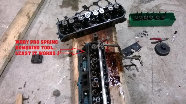

I also disassembled heads today...
might have done one mistake.....
when removing valves, i used bit of force to remove valve, just by hand but it still left small scratch on bronze guide. after i used file on lock grooves.
So brobably least one ruined guide.
Otherwise all went well. it looks like exhaust valves are already hardened.
But i brobably need new valves...

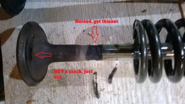

looks like exhaust valve saft is burned, it is bit thinner on spot where it comes out of quide.

Oh and funny thing exhaust valves weren't burned from the saft like i first tough, that was just some carbon deposit :)

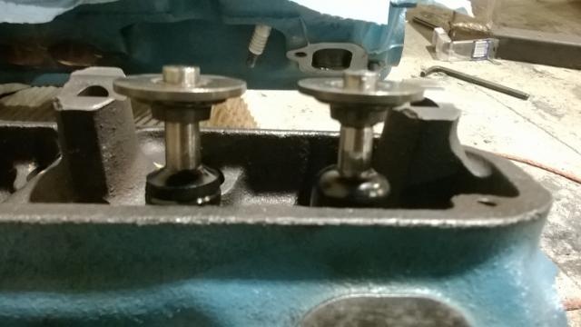

went and measured valve clearances.
And least with stock seals closest valve would have 0.48 clearance, biggest was 0.52.
I measured exhaust side to the start of notch that you see on valve saft below lock to be in safe side.
If i am measuring this correctly and i am not complete brain death :)
But because i dont really know how new seals compare i will be buying those machining tools
Well, I know general rule of thumb is to make sure there is ample additional room on top of whatever the max valve lift is. So, it would probably do you well to cut the guides a bit if you are going to come close to, or certainly if you plan to exceed .480 lift.
