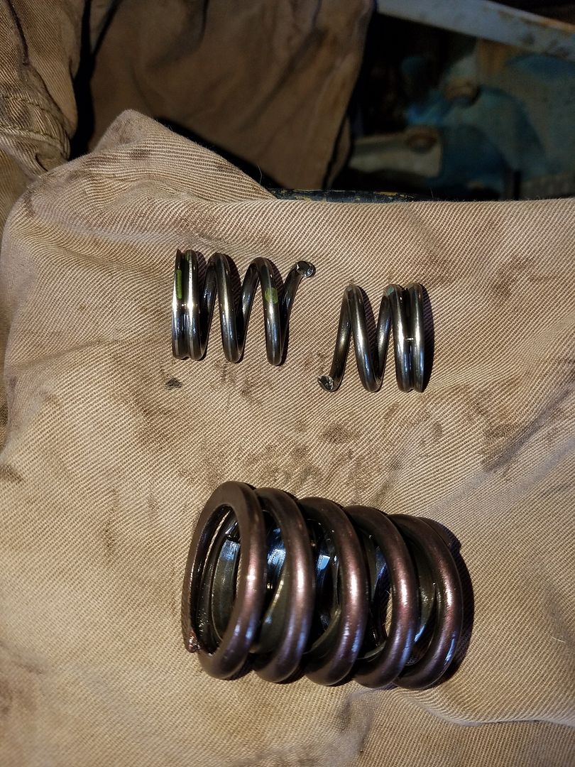

I think I found the problem. It is going to turn out to be valve springs. Today I took the valve covers off and removed the rocker arms. I used my special custom high tech valve spring pressure checker. I reached in and put my palm on the valve spring and pushed. I found 2 very weak valve springs one marginal. I pressurized the cylinder with air and removed the valve spring. I found the inner spring broken. I removed the inner spring and recorded some measurements to get replacement springs. Now just need to buy some. I didn't take the other 2 springs off for inspection because I figured it doesn't matter at this point. It needs springs.
For the record this is the exhaust spring on cylinder 3. Intake spring on cylinder 2 is weak and so is exhaust on cylinder 8
Nice you found it, I just replaced valve springs on my 340 with X heads for a new cam, best bet is to measure installed height and then look for springs. Mopar specs the P5249847 for the 508/292
Single with damper
OD 1.50
Wire Diameter .207
103lbs @ 1.67
260lbs @ 1.27
Install at 1.67 to 1.68
depending on installed height, I would find some similar spec springs, not necessarily the MP springs, they are a little spendy.

Broken valve springs will sure cause the issue you had. :)

did you pull the head, you'd be lucky if a valve didn't kiss a piston. that's a long time to be running an engine with a broken spring.
Didn't pull the head but I did take a look into the cylinder with a bore scope. There are no marks on the piston.
