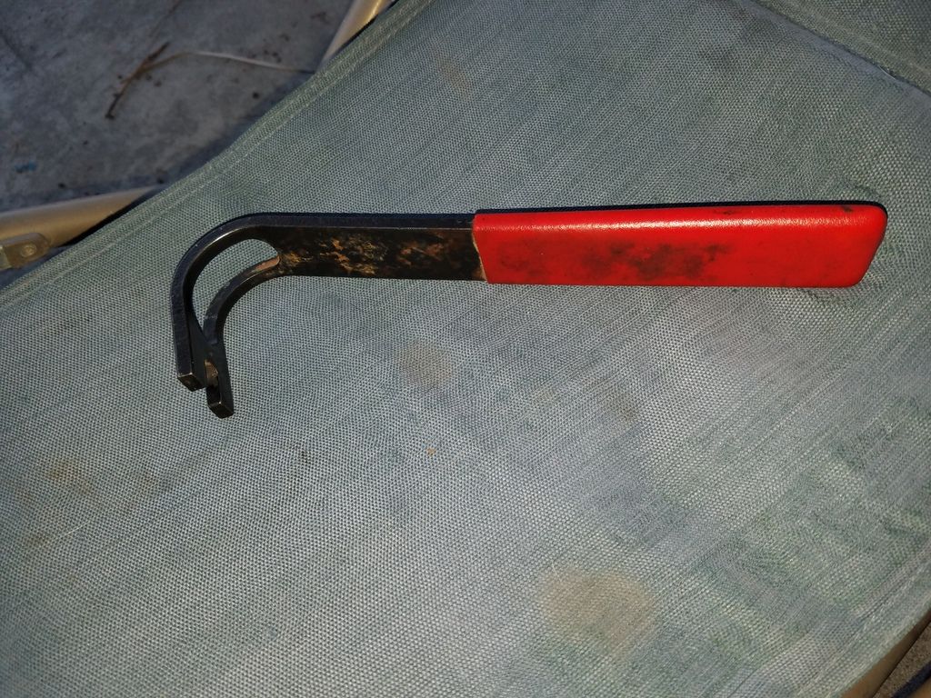

Didn't do a whole bunch on the car tonight. Getting close to 100 outside and more in the garage. I did try a couple of different spring compressors. I have a snap on one designed for a Chevy that pivots off of the stud that worked really well. I put a bolt in the shaft tower and rolled it pulled it at a 45 degree angle from the head over the valve. Changed out a double spring in a couple minutes. Much better than last night. I also took the opportunity to measure coil bind of the old springs. Installed height was 1.73. Coil bind on the outer spring was 1.05 and inner spring was .900. The inner spring sits on a raised shelf on both the retainer and cylinder head. It's installed height is 1.513. Tomorrow I will take them down and have the pressures checked and hopefully get a couple new inner springs.

The tool that seemed to work well last night when compressing valve springs is this one by snap on. Probably could make it cheep enough though.

I bought this one from Ed Hamburgers For 340 only back in the 80s...it would be easy to copy...works great two flat pieces of steel with holes for shaft and bolts onto head.....the apparatus for the springs is curved...bad picture here...i modified it years ago to allow to get to springs with car with the engine set back...
I have a piece of pipe that fits over short shaft to compress springs...can do springs on heads in minutes..
