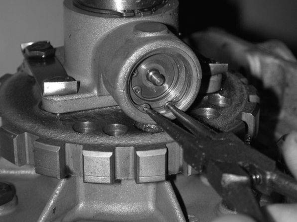

After doing what was already mentioned and you want your shift a little later really easy you can try this.
It works, is easy to do and doesn't interfere with the wide open throttle.
Ok
That's slick! Thanks for the link...
