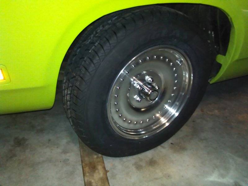

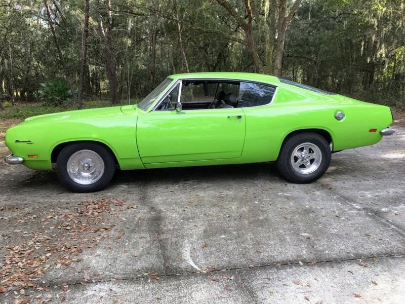

I have an SSBC disc brake conversion on my 69 cuda. It had 14 x 5.5 rally wheels with 215 70 14 on the front when I got it. I bought 15 x 6 cragars 3 3/8 back space, I think. I am running 195 60 15 on the front now. Wish I would have went one size larger.

15X5 1/2" PROSTARS W/ 205 70 15 HANKOOKS------WILLWOOD DISCS

I f ur refering to me , I aint got no torsion bars ! Can barley get a floor jack under it now . That's the only thing stopping me from getting a ''spoiler by Randy" for it now ----
