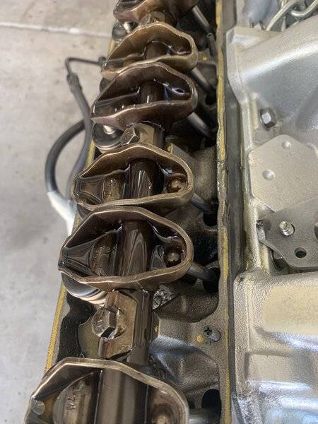

Success! Got oil flowing through all rockers on both heads.

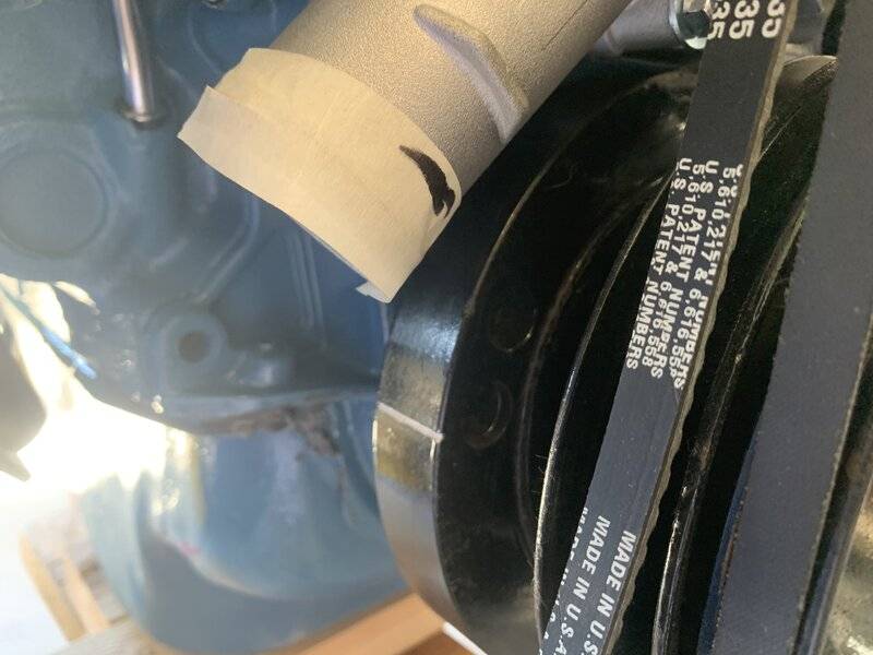

I was turning the shaft with the drill at full speed, “next thing you know old Jed’s a millionaire!!! Oil that is, black gold...Texas tea...” I had an oil fountain squirting a foot into the air! Funny thing though, I noted the balancer position when it happened, and it was right at 0 on the timing cover. Next time around it was maybe 10* before the 90 mark I had made. Is this a problem?
Was it coming out of one head the first time and the other head the 2nd time? If so, that is normal; the 2 sides will oil at different crank angles.
Also a question about the priming process. Once I get oil flowing to the heads, am I done? How long should I let the oil flow?
Yes, you are done.
Yes, the driver side head flowed at 0, passenger side flowed about 100* BTDC. I was concerned that since they didn’t flow at 90 before and 20 after as suggested previously, that maybe my timing was off?
OK, that part about 1 side then the other makes sense.
Good observations on the actual timing. Well, yeah, your cam timing could be off. 1 tooth off is 14-15 degrees. Or the indexing could be off on the oiling holes through the #2 and #4 cam journals. No way to know without timing the cam... assuming it was not done.... which you can do with the timing cover on. How assembled is this engine and is it still on the engine stand? Is the intake still off? Oops I see it is on.

Well, you see marco's opinion.... but none of us here can say if it is timed right or not; we weren't there to observe and check. The oiling index being off certainly does not mean the cam timing is off... But unless you timed the cam, you really don't know. The cam could be ground off-index, a mistake in looking at the dots could have been made....all these things happen from time to time.

The important thing is oil's getting into the heads. A few builds back, the Comp cam in my 440 flowed oil exactly opposite of what the book said. (It went to the DS head at whatever crank angle, when the book said it should be the PS head..) So, I believe the cam makers don't give two shitz about the oil timing relative to the cam position, as long as there's two holes drilled at the proper angle to connect the main journal feed and head feed holes..I stopped paying attention after that. Turn it 'till it squirts!:D
