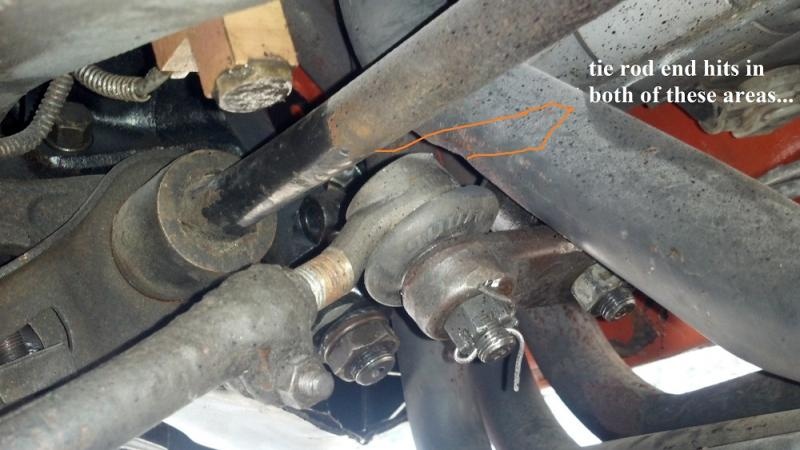

Now which is hitting, the tie rod end or the pitman arm?

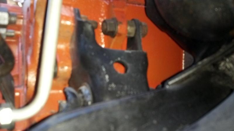

Looks like a spool type of K-Frame from what I think is a bolt shown in the engine photo.
The tie rod end link is hitting right there..hits on both the header and the tortion bar. Im not really sure. Theyre hooker competiton headers. I didnt build the motor or put the motor in it i bought the car with the motor and drivetrain already done.
You have people confused with your title "Pitman arm is hitting tortion bar! Help?" so you are getting some answers directly about the title instead of the real problem. I can fully believe that the tie rod may hit the headers since I have seen the headers dented in many time to make clearance. Have you looked at your lower control arm bushings where they hook to the K-Frame?
Yeah i know i titled this post wrong..after looking at it more closely i realized it was the tie rod end hitting..i dont even know about the engine mounts..im not to familiar with the k members and how the 340 mounts in there..im just trying to figure out what i have to do to get this thing to handle better because right now i can barely drive it down the highway because its all over the road. As far as i know it has all new bushings up front.
I am sure no expert....but arn't the tie rods in upside down? grease zerk goes on the bottom?
I dont know guys im so lost i dont know what to do??? I think the centerlink is tapered one way or the other so flipping the tie rod ends around isnt gonna work i dont think..
Centerlink appears to be straight across and parallel. I just ordered a brand new 73 steering box and a brand new pitman arm..im doing the process of elimination i guess and we will see what happens. I will keep you guys posted. The centerlink looks to be in good shape and everything too..not bent or damaged.
Arent those centerlinks tapered though? I think if i do that the stud isnt going to go through because theyre only tapered one way...
i think the previous owner put it together with a bunch of mis matched parts , something is off , just not sure what .
