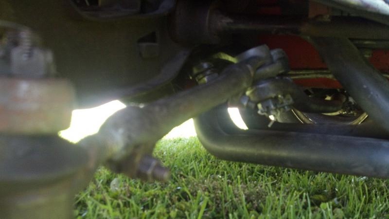

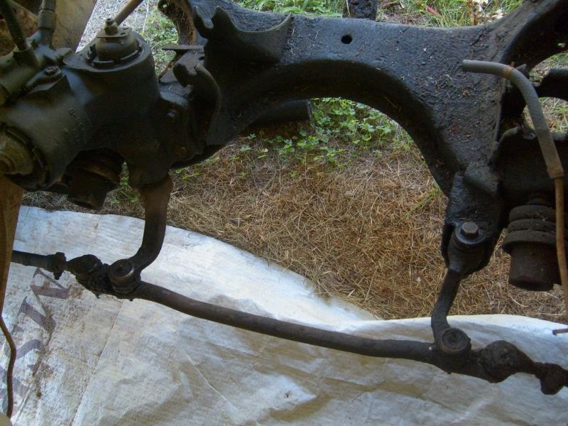

Are my eyes messing with me or is your drag link (center bar) on backwards compared to this one? looks like this one makes the drivers tie rod end lean foward.

First your motor moounts are in wrong. Check the center link to make sure you that you dont have it 180 degrees out of place (end for end).
Looking at both pictures the center link looks on end for end. It appears bowed backward on the picture supplied by another member and bowed frontward on your pictutes.

He's is high on both sides.Your driverside looks lower compared to the pitman arm mounts.I looked at my 70 dart swinger(I konw its a different car) and with the wheels straight the pitman arm is facing straight back and clears the torsion bar by 1" or so.Do yall think since the car is lifted all the way up the front of the torsion bar will actaully drop a litte and cause the torsion bar to move closer to the arm?Since the torsion bar is on a pivot.
Compare yours to the last picture I posted. Looks like the tie rod end is sitting lower on the pitman arm side in the photo than yours is.
It looks correct to me but you know i cant really tell..thats a top view and mine has got the headers and everything in the way idk..its hard to tell..
If i were to loosen up the tortion bars and try to lower the front of the car down i wouldnt even be able to steer my car because the tie rod end would be laying on the tortion bar and i wont even be able to steer it. i have tried..i mean tortion bar would by laying on the tie rod end..

1973 up is a different set up from 1972 back. Tie rod ends on 72 back are ES319R and ES319L and changed in 1973 along with the center link, steering gear box and everything else.
Have someone post pictures of their 1973 up tie rod ends. Look at this picture and see how much shorter the casting is than yours. This looks like a match to the picture supplied by another member.
