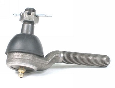

I think the grease zerk was knocked off by hitting the exhaust.on page 5 you can see a dent in the tie rod end and a good size dent in the exhaust pipe so its hitting pretty hard.Unless the tierod ends is about to pop out and is so loose its lifting up in a turn I don't feel it's that.This whole issue was with the steering box loose so I think once that issue is fixed we will be able see if that fixed it or move to another possiblity.I feel it's more aliegnment than parts but thats just my opinion from 600 miles away at a computer screen.I'd love to look at this thing in person.
You pointed out a difference I haddened noticed before. Lots of people opt for C-body tier od ends and adjust sleeves because of their larger then A-body's thread diameter.
That tie rod endin his pic is taller than the stock A-body.

Look at the major difference in there tie rod ends. The new one is a Rare Parts tie rod end. The Rare Parts tie rod end may be just as tall because the bends may be deeper. Also when you look at the new pitman arm you will notice that it is machined around the top. Was the 72 back machined, I don't remember?

It would help if someone that has 73 up would be kind enough to take some measurements for the OP to compare. I am still not convinced that the tie rod end isn't too tall and when you look compare these pictures you can see a big difference in the height. A measurement from the top of the center link to the top of the tie rod end being supplied by a member would be a great benifit to eliminate my thoughts. There is a reason that they changed from an ES319 seriers tie rod to an ES401 series tie rod but maintained the ES319S tie rod adjusting sleeve. When members here have changed their pre 1973 drum brakes over to large bolt pattern disc brakes they have maintained their original tie rod set up so that makes me think the tapered shaft on the tie rod end remained the same diameter and length. I have never said throw parts at this car other than using a complete V8 spool K-Frame set up from a donor car (rusted grocery getter) so the OP will know what parts are really there.

Tie Rod End looks like it is sitting shorter to the center link when compared to Pitman Arm. It also shows a grease zerk.
attachment.php
Tie Rod End looks like it is sitting taller to the center link when compared to Pitman Arm. It also shows no grease zerk.
attachment.php
