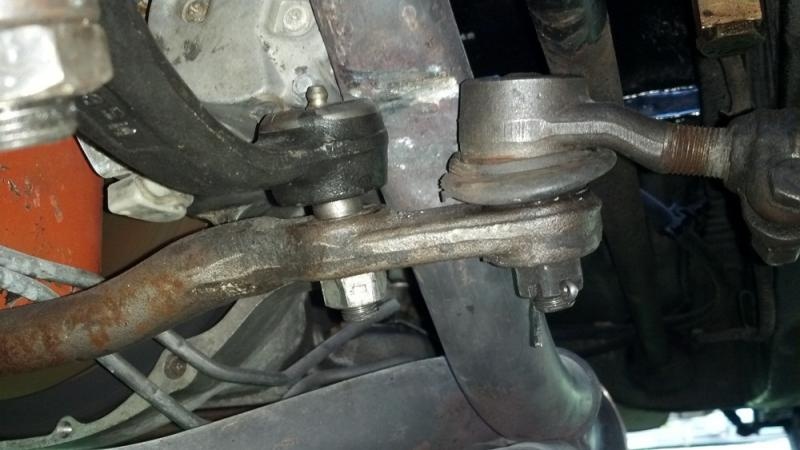

It would help if someone that has 73 up would be kind enough to take some measurements for the OP to compare. I am still not convinced that the tie rod end isn't too tall and when you look compare these pictures you can see a big difference in the height. A measurement from the top of the center link to the top of the tie rod end being supplied by a member would be a great benifit to eliminate my thoughts. There is a reason that they changed from an ES319 seriers tie rod to an ES401 series tie rod but maintained the ES319S tie rod adjusting sleeve. When members here have changed their pre 1973 drum brakes over to large bolt pattern disc brakes they have maintained their original tie rod set up so that makes me think the tapered shaft on the tie rod end remained the same diameter and length. I have never said throw parts at this car other than using a complete V8 spool K-Frame set up from a donor car (rusted grocery getter) so the OP will know what parts are really there.
Known facts are that the steering gear box is coming loose plus the tie rod end is hitting the torsion bar and headers. It would be logical that one of the problems is causing the other. As stated by another member the steering gear boxes have a known issue of working loose and that is why the threads are loc-tited. If the steering gear box is coming loose and the assembly is moving up the tie rod end could be hitting because of it. When the tie rod end (you can see a worn spot on it in one of the pictures) is hitting the torsion bar it could be knocking the bolts loose on the steering gear box. At this point I think this car has an ES319 series tie rod on it and it is too tall based off the pictures posted below. Now this is my opinion and I may be absolutely wrong and Lord knows it won't be the first time.
attachment.php
Tie Rod End looks like it is sitting shorter to the center link when compared to Pitman Arm. It also shows a grease zerk.

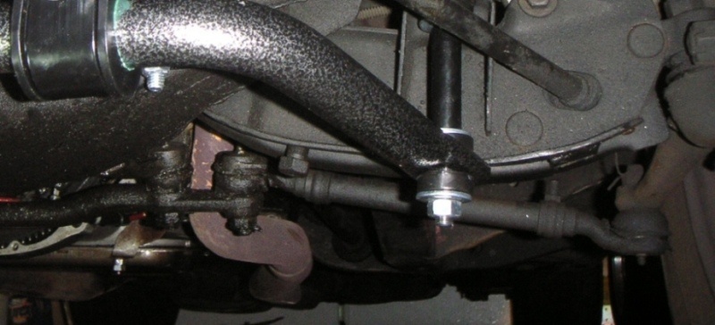

attachment.php
Tie Rod End looks like it is sitting taller to the center link when compared to Pitman Arm. It also shows no grease zerk.

You pointed out a difference I haddened noticed before. Lots of people opt for C-body tier od ends and adjust sleeves because of their larger then A-body's thread diameter.
That tie rod endin his pic is taller than the stock A-body.
