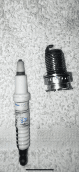

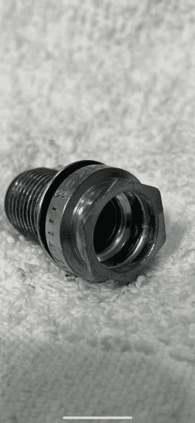

plug chucked in a drill press and a cutter clamped in to a vise. Works like a champ. Takes about 2 minutes to cut the hex off the plug and the ceramic falls out.

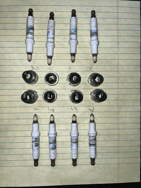

looks like my fuel ring is right at .105 wide. I call that ever so slightly rich but because this is on boost, I’m happy with it. To correlate that to a number this pull was 11.8-12.1 from 3500-6200 on a gas scale.
now I just have to cut 7 more.
All 8 cut apart. I’m not sure I could be more pleased than I am with the tune up. Distribution is strikingly good for a carbureted big block with a large single plane. I see a little variation in fueling but nothing I am going to do anything about. This engine is happy and will live a long life. At some point I am going ask it to make a big big hp number but not for a few years.
That’s about as good as you can get really. You can pick the pepper out of the fly poop but when you run it that close to the edge a weather change can get you into nipping the ground strap off the plugs. Or worse.

I'll tell you this... the spot could simply be wet fuel that pizzled out, like a drop...like residual fuel from a booster but more like the intake runner. I've seen this 'not like this situation'... but with hot plugs that get a drop on them.

Garret, I’m lucky to live so close to a world class dyno room. Steve Brule, IMO, is the industry standard when it comes to running a dyno and tuning this junk. I’ve said it before, when he talks I listen. That being said I didn’t want to wear out my welcome, he is extremely busy and had a free day and snuck me on to
the dyno last minute (I was there Saturday night right as they finished shooting engine masters setting up my junk). Throughout the session I asked as many questions as I could, Steve shared his knowledge every single time, he’s a great Dude. I will cut the shells off the plugs and take a few of them down there for him to look at and get his opinion on. But I’ll have my ducks in a row before I do.

Update, I went down to Westech yesterday to return some arp 12 point bolts we used in my balancer and brought my plugs with me. I walked in right in the middle of an engine masters shoot, oops. I apologized and said I’ll come back but Brule actually took time from filming to come examine my plugs, I can’t say enough nice things about him. He was thrilled that I cut all the shells off as he says his customers rarely do that and bring them back for him to look at. Said it’s nice to see his equipment is still producing results he expects. He’s happy with the fuel ring, and where the timing is at, as well as the heat range at 7 and has exactly the same opinion on the dark mark at the end of the ground strap as I, and some others here have. He said it’s likely some turbulence in the chamber and where the plug is located. I asked about indexing the plugs and he said he’s never seen it make much difference. He also told me again he doesn’t like the projected tip plug and told me I probably won’t see that mark show up with a standard tip plug. I put a set of NGK R5671-A7 plugs in it and will come back after the engine is in the boat and I make a couple runs to show you guys what the plugs and the tune up looks like in the boat.
