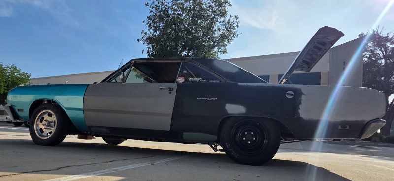

Figured I would post my Duster combo here while I still can.
My car ran a best time of 10.4 @ 136 and fastest mph of 10.7 @ 139. My converter was wayy too tight so I was leaving the line under 2500rpm.
All steel, all glass 1971 duster. Unknown weight
Combo is a stock stroke 360 magnum with all forged internals. Block half filled. 9.2:1 compression, CNC speedmaster heads, 227/230 .600 hydraulic roller. 7875 turbo, air water intercooler, 16psi boost, e85. Duel knockoff 400lph pumps, id1050x injectors running at 60psi base. Edelbrock carb intake modified by myself for MPFI. Microsquirt ECU tuned by me.
727 “fully built” from CRT parts. Steel front drum, full roller, CRT RMVB. 9.5 torque converter from Gillece setup as tight as they could get it(too tight after switching to Hy-Gard fluid). 9” rear with 3.25 gears. 275 MT drag radials. Foot brake.
