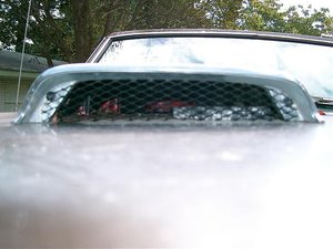

Been there, done that. So I made these little Screens to prevent a repeat:
After I cut them out to fit corectly I coated them with Black Plasti-Dip.
The top sticks up behind the Bezel to brace them in place.
They mount with the factory Bezel Screws with a small Washer so can be easily removed for cleaning.
Hope this helps!

hmmm never heard of a bird being sucked in there, seems like it would be an awful mess, nice work on the screens, what did you use for them?
I bought some bulk screen offa ebay that was listed as Grill Inserts for Ram and Dakota/Durango's.
I actually sucked in 3 birds over a few years. The last one was the one that somehow made it through the hole!
That was enough of that for me!
