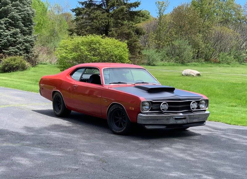

I have been focusing on handling parts for my Dart. This virtually always means a serious ride penalty but that roughness can also improve the sense of connection with the car in addition to better handling manners and predictable limits. I have done complete suspension setups in several cars (late model Mustangs, Miatas) so I was pretty well prepared for some "harshness" but this just doesn't quite feel right.
I'm wondering if my setup is just suffering from being too low (lacking travel) or of something else is going on but the car basically rides like crap. It bangs and shudders over bumps and feels just jittery but still lacking any sense of satisfying feedback.
I have chassis reinforcements still sitting in a box, waiting to go in the car (torque boxes and subframe connectors) so I haven't even dreamed of pushing it through any corners yet but nothing about the driving characteristics inspires confidence.

Looking at the car, it doesn't strike me as being extremely low...
(Yes, I know the hood is still crooked...It still working on that. I just got impatient and wanted to go for a drive :D)

Thats a tough one. I'm sure the folks will ask for pic's of the setup. Are you bottoming out on the bump stops? Is anything hitting anything else on bumps? The whole car does seem a little low, but I'm sure since you are going for really good handling, thats what you want. With all the adjustable parts, I'm sure a good alignment is achievable. What are the numbers set at for it?

Yeah, I am wondering if I am on the bump stops...but the car really doesn't seem that low. Cutting the bump stops doesn't seem like the best idea but there must be some way that guys are able to drive around lower than my car.

Bump stops would be the first place I'd check. I think Energy Suspension sells replacements, I'd get those and trim them as needed of you find your riding on them. Secondly I'd check shock travel. You may be out of their range or simply got the wrong pair. On your sway bar, does it pivot freely? I've found I needed to shim some sway bar mounts to keep them from clamping he bar too tightly. I've seen hollow bars break from the mounts being too tight.

Cut the bump stops or buy some shorter ones, at that ride height you are using the rubber for suspension.

Take the bump stops to the bench grinder, give them a smaller point in the middle, give it some thing to hit over bumps but it will be a lot softer

Also make sure you tightened all suspension bolts with the weight of the car on the wheels. If any were tightened with the suspension hanging loose, that very well could pose a lot of problems. The suspension would be preloaded when you let it down. If there's any doubt at all, I would go back and loosen everything then re-tighten with the weight on the wheels.

2. Make sure the LCA pivot pin wasn't torqued before the weight of the vehicle was on them. I kind of doubt it is an issue if you have poly bushings, but something to look at.
For what it's worth, I know I am just touching the bumper to the frame, with the stock bumper. If you are running much lower than I am (hard to tell), then you are probably compressing the bumpers and don't have any travel.

My money is on the fact that the OP just needs to adjust his range of travel with revised bump stops and then he will be talking about much he likes the ride.
I purchased the bump stops 72BluNblu recommended, but nowhere near to being on the road yet. My guess is you do have a range of travel issue at the very least, & these would be a big step. torque sequence & weight on the wheels also.
