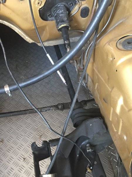

A lot of guesses about bump stops but QA1 LCA have neither the same issues as a stock LCA nor the same remedies.
Probably a good idea to make sure your Qa1 actually have bump stops at all.
Or if it DOES, is it adjusted properly???
This one here is set WAY TOO HIGH

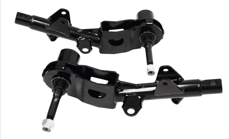

QA1 LCA's are one of two versions. The early ones don't have any bump stops at all. None. So unless you mounted the stock lower bump stops somehow/somewhere, there's no bump stop. Now, with 1.14" bars and that ride height you shouldn't actually have an interference problem. The bump stop-less QA1 LCA's have a lower profile height than a stock LCA, and because of that they add almost a full 1" back into the suspension travel. That's a 2" height drop at the wheel. That's the kind I run, and that's why. I did add bump stops back onto my frame stops, but just the little poly disks shown in the linked threads above. Just to keep from going metal on metal.
The latest version of the QA1 LCA's has a bump stop. A pretty large poly bump stop. I haven't laid hands on one of those yet, but just based on the pictures I'd wager they actually reduce travel with the bump stop they come with. So if you have those, you could be sitting on the bump stops at your ride height. And those are poly stops, so, unlike the stock rubber bump stops there's little to no cushion. If you're bottoming those out the ride quality will be terrible.
With a 1.14" torsion bar, you'll need close to 1" from the bump stop to the frame at ride height if you intend to stay off the bump stops most of the time. I run just under that with my 1.12" bars, so you may get away with a little less, but it depends on the weight of your car too. You still have all the stock '74 stuff up front, so you're hanging more weight off the front of that car than I am now.

This is my set up. Notice the really tall upper bump stops, and the really short bump stops on the frame stop. This is obviously on jack stands, the UCA is on the upper bump stop. My typical ride height puts just under 1" between the bump stop on the frame and LCA.
Bump stops would be the first place I'd check. I think Energy Suspension sells replacements, I'd get those and trim them as needed of you find your riding on them. Secondly I'd check shock travel. You may be out of their range or simply got the wrong pair. On your sway bar, does it pivot freely? I've found I needed to shim some sway bar mounts to keep them from clamping he bar too tightly. I've seen hollow bars break from the mounts being too tight.
Nice looking car BTW.
Energy suspension sell the lower bump stops you can get 2 lower than factory. Go on their site great people to deal with .

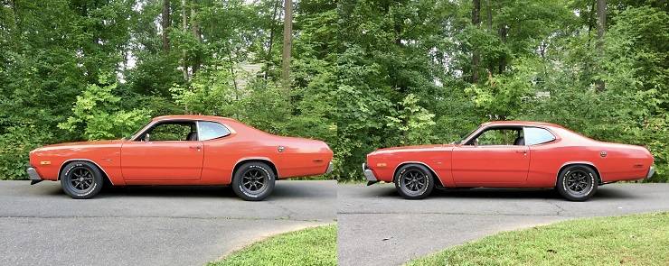

- I’m confused about the rear ride height. There’s not a whole lot involved in installing leaf springs…I have the Hotchkis body mounts, stock shackles. After the install, the car was higher than it was with the original (very tired) springs.
This is the ride height comparison before/after the lowering blocks...in fairness, they were brand new in the first picture so perhaps they had yet to settle? That still doesn't explain why I needed lowering blocks to get where I am.

Yeah, I am wondering if I am on the bump stops...but the car really doesn't seem that low. Cutting the bump stops doesn't seem like the best idea but there must be some way that guys are able to drive around lower than my car.
