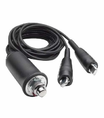

YOU MUST get a voltmeter and make some checks
Get it down to SIMPLE IE eliminate all wiring, relay(s), etc.
This means use either a starter button or a screwdriver to short
1-- between the starter relay battery stud and the "square" terminal of the relay.
2--If that does not work, jumper directly across the two terminals on the starter.
3--Clip your voltmeter onto the starter main (large) terminal, and to the engine block. DURING the time that you are jumpering the relay and attempting to start the engine, you should see at least 10V at that point. If you do not you have one of the following problems
