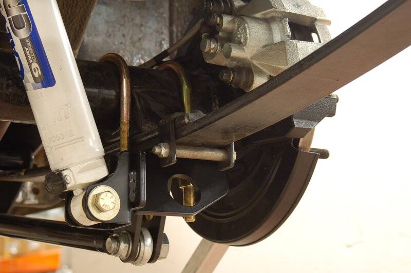

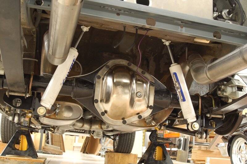

Got the Dana 60 back in the car. I built new shock plates for the Calverts since I didn't like the plates that Calvert includes with their kits.
View attachment 1715567699 View attachment 1715567700

Hi Andy, Just curious, since this car will see a lot of street use, in the categories of ride vs traction, what do you think of the Calvert system vs a set of Mopar Super Stock springs. Not from personal experience, but I have read the Calvert system was a little hash on the street. And to address the issue of the car sitting unlevel on the super stock springs, some use the same side for less or more arch / height.....also use the lighter weight 2800 lb to get the rear ride height lower.
I have SS springs in my other car and I prefer the ride quality of the Calvert split mono leaf springs. The Calvert linkage rattles when you drive so it is noisy, but the ride is nice and smooth. I think the split mono leaf design is far superior to the super stock spring design. With the split mono leafs you can change the spring rate and/or the ride height fairly quickly. SS springs are difficult to work on unless you have the correct tools. Most people never take apart a SS spring pack to change the ride height or change the spring rate. Individual springs aren't easy to come by for SS springs while Calvert has a full selection of mono leafs on the shelf.
Thanks for the reply. I agree, most people would not take apart the SS springs, but maybe because they are available in different spring rates, simply buy what they feel will work best, ride height wise. My thinking, and I could be wrong (ask my wife) is that if I wanted the rear to sit lower, I would buy the softer (2800) springs for my 3400 lb A body.....maybe I'm under thinking it.
if it were a track car....I would not hesitate to go Calvert.
Just depends what you're trying to accomplish. If you are interested in ride quality then you should invest in a split mono-leaf spring. Any spring pack has a lot of internal friction from the leaves sliding over each other. That friction is what creates the ride harshness since the leaves stick at first then slide. It is all very non-linear behavior which you feel as "harshness". Try some Calvert split mono-leafs on your car but leave the front pivot and link bar off. Just use the springs and then a snubber or whatever else you currently use to control the wrap. Buy a high quality shock and you'll have a nice system.
I got the calvert rattle on my drivers side , going to titen it just a hair . Also , I have a pair of 002-003 springs that had bent the pass. side right behind the front spring eye , (mexico made ) , I took it apart and cut a special reinforcement 2bd leaf for it , trying to not raise the car , but ran into the complete calvert set up cheaper than I could buy , so never really tried the s/ springs . taking them apart and reworking and putting them back together aint no big deal w/
c grip vise grips ,and a long tapered punch to keep the holes lined up .
