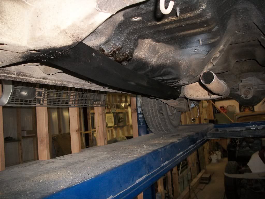

I saved these that pettybludart built for his 66 Very fast Dart
This is what I will be doing, Thank you pettybludart.
HaHa,dam MeMike that,s an old pic!
Yes they are :D and just look how well they have held up in your monster small block early A 66 Dart :cheers: I bet they are nicely painted now :thumblef:

Mine are designed and built just like yours, and I didn't like the flimsy aftermarket stuff either.
Mine are 085 wall 2x3 laying flat.
What a MAJOR difference in the feel of the car, especially around corners and in and out of parking lots.
