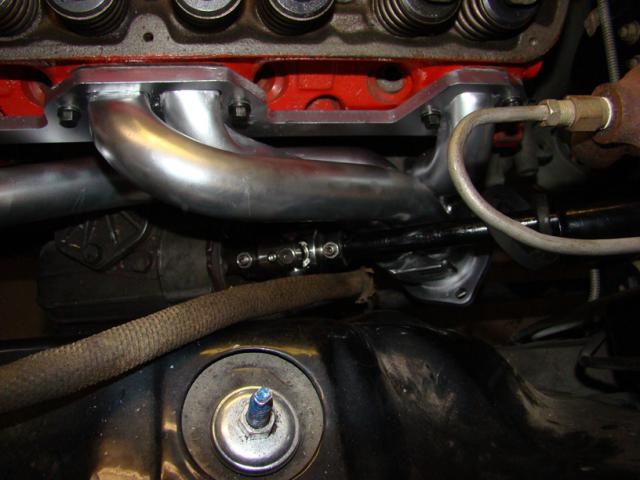

1st gen barracuda with power steering and column shifter? That is like the triple defeat of header hopes
Sanderson headers and especially Carlos stepped up to make it happen. And with black ceramic paint. Also opted to upgrade my exhaust and add an H pipe
I can feel the increase in power. And she sounds a little meaner

...........Just got back from their website.........I assume this is a custom made set?
Looking at the pics you linked to they look highly modified.
Over $500 to buy them then what was it to modify them?
wasn't that much to modify - do not have details
I also had them redo the exhaust and mufflers. All the materials and work wasn't bad at all
not much to modify.. wa it $50 or was it $500 to do? there has to be some kind of ball park figure.
I think he means that he did not have to cut or bend the headers, just hook his exhaust up to them. Look like they fit real good, better than my DD7s. Mine would have never worked with the stock rag joint and other "mods".
There was not a detailed SOW, to modify was a few $100 or less
I had a lot of work done, headers, plus coating, plus modification, new exhaust, H pipe and magnaflow mufflers and of course installation. So a few hundred more than TTI headers
Modified (or semi-custom) dd8
https://www.sandersonheaders.com/sanderson-dd8-header-set-for-small-block-chrysler-engines.html
These are shorties. and with the exhaust work, woke up the car a little bit
I have to tell you that comparing your photo of your driver side to the graphics of those headers, that cannot possibly be the same ones...........or they've radically modified the front tube(s).

Lets call those Sandersons dd8.1's as the #1 tube is completely rerouted from the originals. Looks lie its a better design anyway with #1 coming up and back and #3 going between the strter and the block. I modded some 67 Supercomps like that for my '65, tucking the #3 down there and running #1 back like that. Still in progress.
