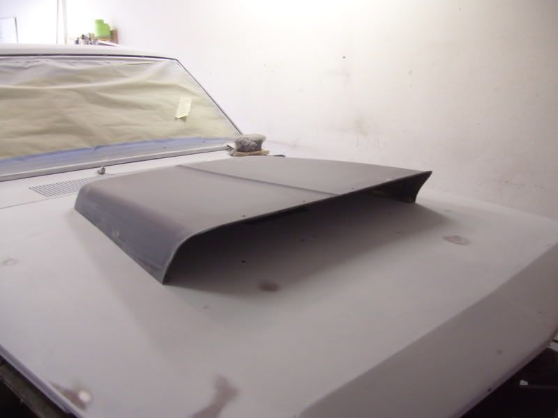

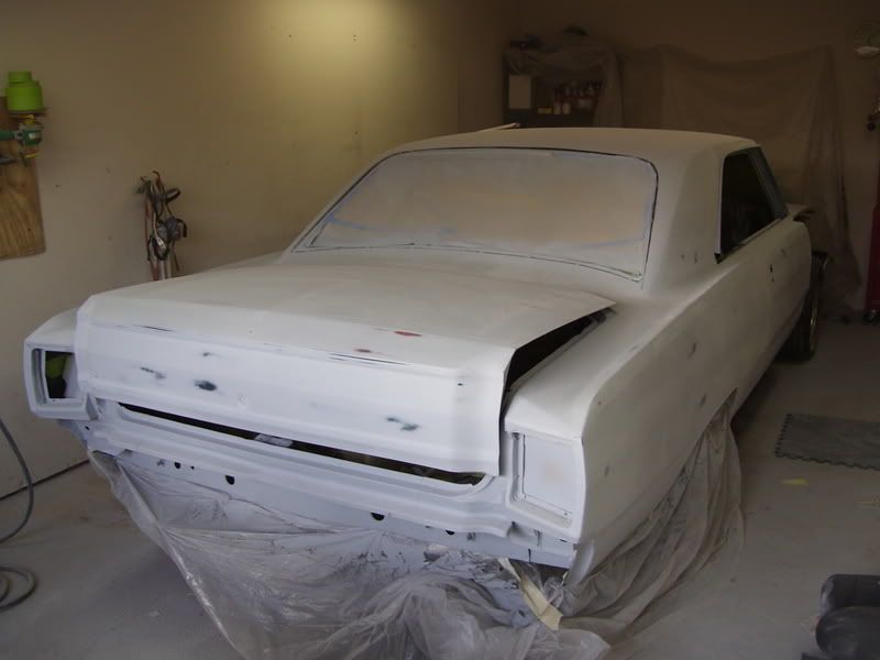

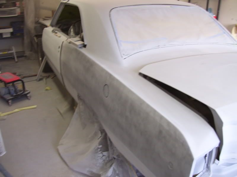

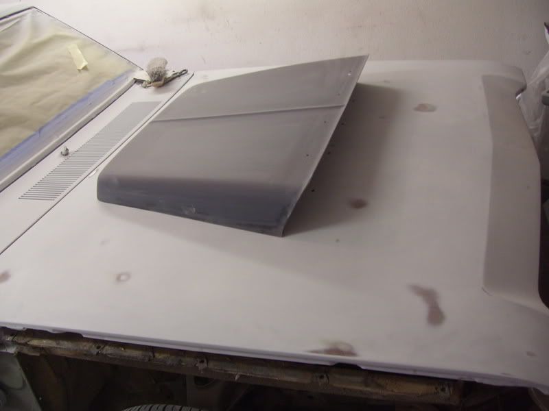

Another update. I spent the day doing the final block sanding, the body is straight, but I sprayed another coat of filler primer a few weeks ago, a couple of weeks ago we hung the doors, hood and trunk. Today I got the doors and hood aligned, then I blocked most of the body with 320 grit. I almost got it all done, but I still have to do the right rear quarter and both front fenders.
I was originally going to paint the engine compartment after wards, but I am thinking about stripping it out and doing it at the same time.

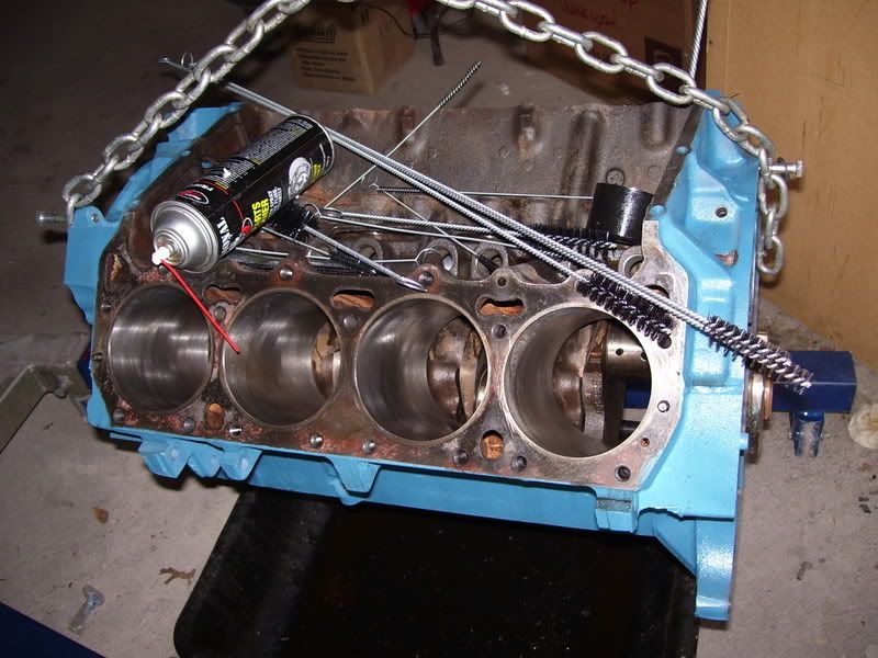

I did a little more work this past weekend, mostly cleaning the garage (I tripped twice in 3 minutes on the same crap on the floor, time to clean), the last part of the weekend was cleaning the block, getting it ready for assembly, I used engine brushes and brakeleen.
