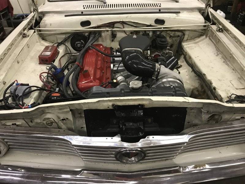

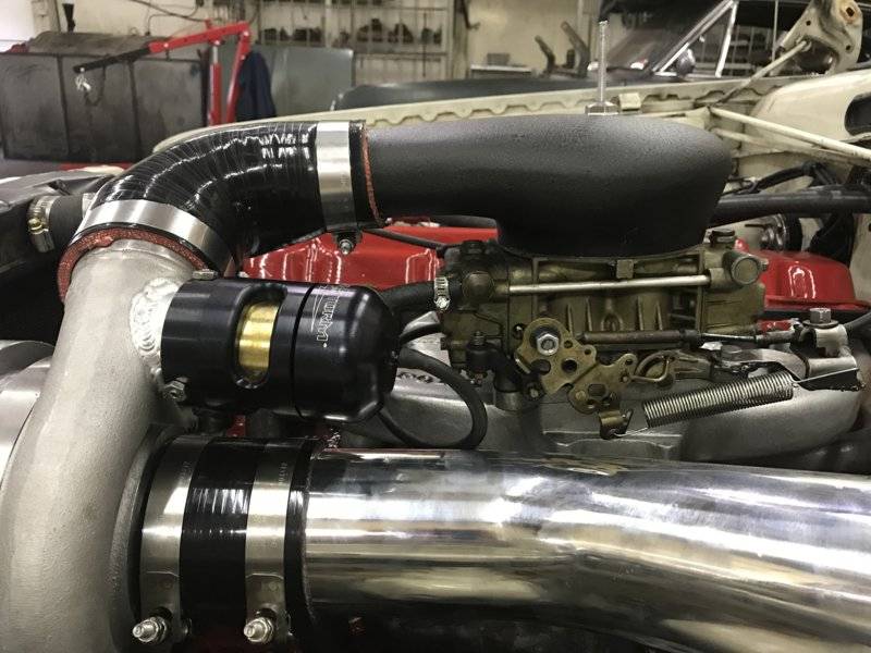

This is the supercharged slant.
With only 4 mains I wouldn't boost it too much. The competition has 7.
While true, I read a study quite a while ago that showed the stresses were more acute on the crank w/the 7 main arrangement, but a lot less rotational mass.
Take that for what it's worth, I'm not endorsing either as "better" particularly, just puttin' it out there.
Will Burns doesn't seem to have the 4 mains popping out the bottom, and neither does Steve Nitti in His Supercharged 10 sec. Duster, so it's not kryptonite by any means.
.040 bored block
Molinar Rods
Wiseco pistons
Head home ported
Steel shim head gasket
